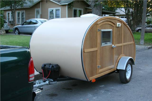

Philip, sorry we're hijacking your thread. I've been watching your build and really like the way it's turning out. I kinda wish I would have used "bolder" color vinyl for the roof (Forest green or Burgundy), but felt something lighter colored would be cooler in the south Texas sun!!! I'm going to answer "Looped's" question and ask you one.
Haven't pulled my TD much yet, but I am concerned about rock damage to the vinyl. Funny thing is, just today I went by a friend's sheet metal shop to get him to make me a piece of "quilted" stainless for a rock guard. My thought is that the Stainless might resist dings a little better than aluminum and the weight difference should be minimal. So hopefully He'll have it ready for me to install it this weekend.
Philip, are you planing anything for the front of your's? If so, What? again your build is looking really nice!

DBizer wrote:Philip, sorry we're hijacking your thread. I've been watching your build and really like the way it's turning out. I kinda wish I would have used "bolder" color vinyl for the roof (Forest green or Burgundy), but felt something lighter colored would be cooler in the south Texas sun!!! I'm going to answer "Looped's" question and ask you one.
David
Yea, I plan on some sort of a tongue box...I can't finalize a design right now...I just have some ideas kicking around. I want it to carry the spare wheel...I know that much...I guess the design will come to me in a flash of inspiration....yea, I even get those once in a while.
