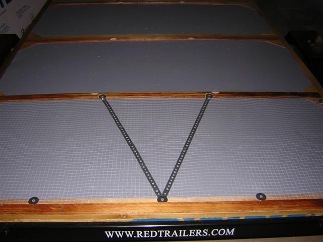

Postby S. Heisley » Sat Aug 09, 2008 11:52 pm
Okay, I'm feeling a bit smug right now; so, if you're going to burst my big-headed bubble, please be kind about it. :lol: (Seriously, if you do see something wrong, I've only finished the first section....)
I carved spaces to fit 2/3's of the diameter of my Ga. fender washers and just deep enough so they won't touch the metal chassis. Then, I supplemented those attachments with a bit of Ga. metal plumbers tape. Everywhere else that I used washers had good contact with the hardware cloth and won't touch the chassis.
http://tnttt.com/album_ ... c_id=39637
(This is the first time I've tried imbedding a picture, so if it doesn't work, the picture is in my album.)
The carved areas won't hurt the structure any as the dark strips that I carved are in the spacers used to make the deck fit without dipping on the metal cross-bars. (The metal cross bars are soldered inside the frame sides, making those parts lower. ) Of course, hindsight is a beautiful thing and, if I had thought of it, I would have fitted the Styrofoam and run the hardware cloth under those wooden spacers. Alas, the wooden spacers had already been PL-glued and three coats of epoxy had been applied by then. FYI: The Styrofoam has been painted with external water-based paint to protect it from petroleum products that might splash up in rainy conditions.
