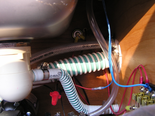

Quick picture
Postby dreadcptflint » Fri Aug 08, 2008 10:50 am
Right now the primary culprate is the small clear tube gowing from the bottom to the top. It runs from the pump to the facet. I already tightened a couple before I went out and checked for leaks when I sanatized the line. (There was only one that I tightened up).
As you can see every hose has a clamp at both ends. Should I go to a more plumbing type model or just tighten down the offending tube and hope that it doesn't loosen up again?

From your photo, I can not see what type of a barbed fitting the clear tube is connected to. it is also difficult to see, but it does appear that the
clear tube is deforming over the fitting, making it appear that the fitting may be too small for the tubing, which in turn as you tighten the hose clamp the tubing actually tries to wrinkle as the clamp tightens forming a small but efficient leak path. lossen your hose clamps and make sure that you have to work the tubing off the fitting, if it just falls off the fitting is too small. :thumbdown:

I agree with Al most barbed fittings will seal on the poly tube without excessive clamp pressure the only reason to spray is a hole in the tube or the tube is simply to large of a inside diameter for that size barbed fitting the easy fix is to just install a larger barbed fitting 2-3 $ at a good plumbing supply place.

Actually if it was mine, I would do away with the poly tube and use a piece of the reinforced tube (of the correct size) like was used for the vent line beside the tank fill. While the poly will hold the pressure of an RV pump, it is easily deformed with a hose clamp, it really works better with compression fittings.

I got a little time today. (After chugging some soap thanks to my little dude). I replaced the clear tubing with some reinforced. It was a whole $.60 a foot at the hardware store. It should hold now. If not then I will spend the couple of bucks to get some better fittings. (I prefer brass over plastic every time). I gave it a quick tester and it appears to be working with no drips. The real test will be when I take it out and hit a few more bumps.
