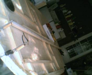

Postby Miriam C. » Tue Aug 12, 2008 10:42 pm
Oh dear! You won't need too much framing with 1/2" sides and 3/4" floor. Here is mine>
This is one of those things I wish I had taken more pictures of. I kerfed the top curved part of the framing and put PL glue in the voids. Just like a house wall. Easy frame. :thumbsup:
