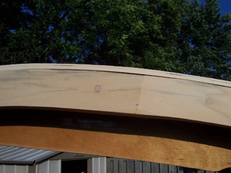

Finally got a dry sunny day. This summer has been really wet, with rain happening almost every other day, including most weekends. I mentioned in another post how my epoxy was starting to peel away from the edges of my trim work
http://www.tnttt.com/viewtopic.php?t=24413&postdays=0&postorder=asc&start=0 and it has gotten worse. Because of the weather, and inadequate covered storage , the damage has intensified to the point of being unrepairable. The epoxy on my trim has peeled back from the edges and the wood has turned black. Today is the first nice day I could work on the trailer. I took the tarp that I threw on a couple of days ago off, and my heart sank. My roof now has white spots all over where the epoxy has softened and blushed. The trim is a mess, and I'm just ready to cry.
So here is what I started to do.. On the flat pieces of the trim, I used my planer to remove the epoxy and some of the wood. didn't work... the black goes too deep. I bought a Bosch orbital sander and continued to sand the trim. I used scrapers to remove the epoxy... it came off in sheets. The wood underneath was saturated with moisture because the epoxy had split.No matter how much I sand off , the black stains persist. I had some deck bleach left over when I refinished my deck, and used that. They didn't go away. Now I think I have no choice. I will continue to sand the trim until the epoxy is removed and then prime and paint it. Probably the same color as the fenders.

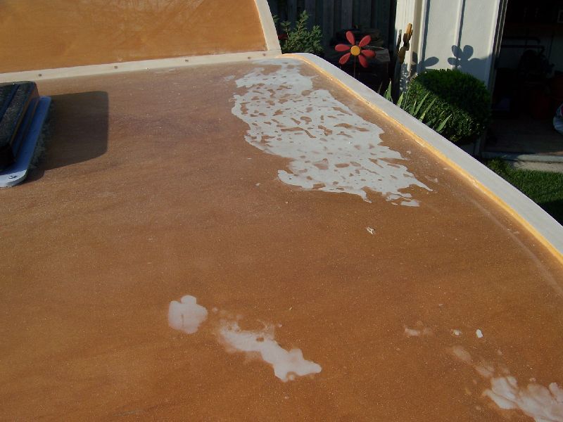

The roof is repairable. A quick sand, another coat of epoxy, and the varnish or clearcoat.

Sorry to hear of that John, but I think the moisture got under your epoxy somewhere and caused it to lift rather than the epoxy splitting and causing it to happen. What you have described is exactly what happens to a wooden boat that isn't encapsulated . I'd think it happened because the trim went on and then epoxied up the sides. Under the trim, there isn't a good epoxy coat and with a tarp left on, It held the moisture in. If all those trim corners where they mate to the side weren't sealed up well, water will get in and just sit...It's looking for a place to go so it wicks into the wood and causes the epoxy to lift.
Whatever you do, you ought to make sure that you seal up all the edges of the trim on the sides/roof with some thickened epoxy as a fillet or if you are against epoxy at this point, something needs to seal it. It's unfortunate to have happened to such a nice looking trailer. Doug

I guess I was wondering why the large opaque spots on the roof. I was thinking it maybe could be related to your previous blush problems that you had, but you stripped that all off... :thinking: Your trim issues are for sure caused by the sharp edges. I found that out the hard way also, I thought I eased the edges enough but in some places it needed to be taken care of. Doug

PS I work in wood buiseniss. If the wood is black inside and outside, Through and trhough, the wood is dammeged for the rest of its life. The only thing you can do with the wood is impregnate.

:o John I used spalted Maple and it has continued to spalt. Blacker and pushing out the epoxy. Somewhere my friend the wood salesman found an article where woods that are inclined to spalt under the right conditions will do so if epoxied.
Rot Doctor said treat with CPES, presumably all over it would prevent the process. You might be able to use the darkened wood to your advantage and make a faux treatment but use the CPES to harden the wood first.
Other wise you should strip it off and start over. That is what I am doing this fall. The top is getting painted or vinyl. :cry:

The blushing on the top of the main cabin is most likely caused by moisture inside the trailer. The constant rain environment coupled with warm summer days would push the moisture up through the roof and get trapped underneath the epoxy coating. The only way to eliminate this would be to thoroughly dry out the inside of the trailer and if possible epoxy the interior underside of the roof.
The staining of the trim boards may be caused by affixing the trim to the sides before applying the epoxy coating. Moisture is seeping underneath the coating and causing it to lift. I would remove the trim, allow to dry thoroughly and then sand. Afterwards I would coat liberally with a good long oil alkyd paint or varnish. If you go with the varnish you can add any color stain directly to the varnish and coat your trim. However, keep in mind that any clear coating (even with uv blockers) would probably need to be refinished every few years. With a paint, you can get longer life as the pigments inhibit the breakdown of the resin holding the paint together.

I got most of the trim sanded, and then ran out of paper for my palm sander. It "almost " looks good enough to re-epoxy, but the black streaks really show when I wet them out. Epoxy and varnish will give the wood a yellow color...see original pic.....but I like the real "Blond" look of the trim, so I've decided to paint. I think I'll go with a marine paint called Epiphane (I think), in an almond color.The sides will have to be resanded... the sander slipped a few times, and the roof as well...see pics below.

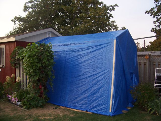

Winter's not a problem doug,I keep it in this
I just have to take half of it down every spring so i can pull the trailer out!! :lol:
