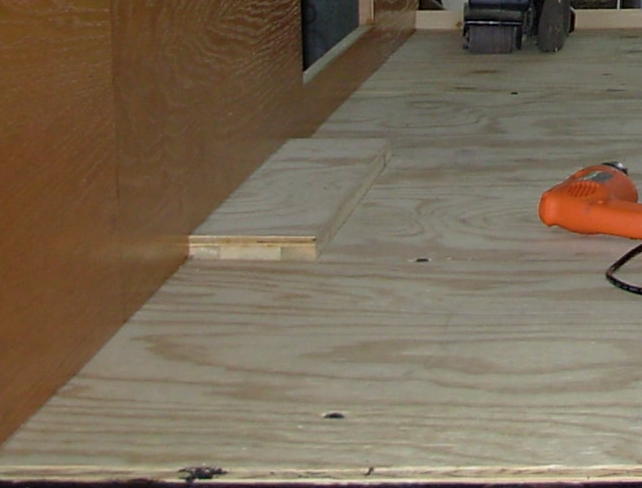

Postby ssrjim » Mon Sep 01, 2008 9:33 pm
I used 1/4 inch bolts:
I counter sunk on the top side and filled the holes with wood filler.
