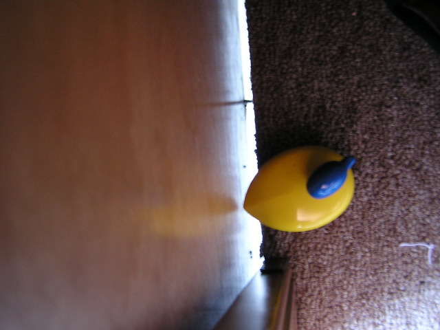

Here is my trailer:
Yesterday in Moro Oregon, I noticed some light where there was not supposed to be light. It was coming from the bottom of my floor because the trailer body was seperating from the frame. I am more than upset because it looks like the manufacture only used two three inch self tapping screws in the wheel well to secure the structure. Yes, that is right folks no glue, no joints, no bolts.
My thought is drilling three bolts through the diamond plating, trailer body and frame after securing it with some glue. Any thoughts? How would you do it to be safe and secure?[/url]

Postby dreadcptflint » Mon Sep 01, 2008 11:23 pm
I uploaded four pictures in my gallery.
There are only three screws holding the fender on and it looks like they relied on them to keep the sides to the frame. I put on at least 1000 miles in the last couple of days and as you can see they didn't hold. I now need to figure out the best way to fix the problem with out ripping the entire trailer apart.

Postby satch » Mon Sep 01, 2008 11:37 pm
Is there anyway to remove the dia. plate, and compress it back with some glue and more bolts? It's kinda hard to see the depth of the damage from your pics (atleast for my poor eyes). Either way, I would have some "choice" words for the dudes who built it. If it's what I think, any new bolts would be covered be the dia. plate when reinstalled.

Postby mikeschn » Tue Sep 02, 2008 4:09 am
I too am trying to understand what is happening.
Is the wall pulling away from the chassis? Is it bowing out at the bottom, while it's still attached at the top?
Is the wall pulling away from your cabinets too?

Postby dreadcptflint » Tue Sep 02, 2008 9:26 am
The walls appear to be still attached to the cabnets and the supports up top. It is just bowing out from the chasis. At one side the gap is only two feet. The other side I am looking at about four feet of bend. The gap on one side is over a quarter of an inch wide so I think that I will be able to reglue it and hit it with some C clamps.
The diamond plate is on solid i.e. would have to be cut off and rewelded to get to the next level.

Postby doug hodder » Tue Sep 02, 2008 9:51 am
Hard to provide the correct fix not being there to see it. I'd think that any "fix" on the loosened portions might only cause it to pop loose somewhere else on the side. Can you push on it and move it back into place? Are the screws just sunk into end grain on ply or is there some sort of a cleat? You could remove the carpeting, make a wooden cleat and epoxy it around the perimeter to the side and floor on the interior. Or some thickened epoxy in the gap and clamp it from side to side for a localized repair. Lay a piece of 2" masking tape on the interior wall at the floor so you don't get the glue on the interior paneling. Are the bottoms of the sides sealed? If not, water may cause the ply to delam.

Postby dreadcptflint » Tue Sep 02, 2008 10:39 am
Doug,
When I push on the bottom, it does move back into place. The screws are sunk into the end of the ply which are not sealed on the sides. The manufactor is very aware that I am on this forum.

Postby doug hodder » Tue Sep 02, 2008 10:46 am
I think I'd crawl around under it and check out all the edges/ joints especially before you do much driving in wet conditions. An overall repair might save you headaches down the road as opposed to a local fix. Your comment on the 90 day thing indicates it had a 90 day warranty. However I'd think they ought to do something to help take care of you on this. Doug

Postby bobhenry » Tue Sep 02, 2008 11:39 am
dreadcptflint wrote:Doug,
If I can ask what make is it ?
What type of wall treatment is inside ?
I have never taken a vehicle back to the dealer.They rate right up there with lawyers , doctors , and undertakers as the type of folks to be avoided if at all possible.
If it were mine I would run 3 or 4 xtra long pipe clamps under the belly of the trailer and block both sides with a 2x4 laid flat to evenly distribute the pressure and glue first. If it were possible to remove the carpet I would use fiberglass and that fiberglass mat and run 3-4 inches up the side wall and on the floor front to rear on both sides. after 2 layers just a final coat of resin to smooth everything out. Grind or beltsand smooth and reinstall the carpet . Use a complimenting trim as "baseboard" to hide the sidewall repair. If there is a chance the side wall treatment will seperate from the wall you may want to remove it to the top of the baseboard to be added.

Postby jagular7 » Tue Sep 02, 2008 2:51 pm
That is what had happened to my td I once had. Less than 8 months old to boot. The mfr had to rebuild totally. I sold it while it was being rebuilt to a distributor for the mfr. The side panel is separating from the floor.
About how to fix it, I would suggest you remove the frame from underneath to give you better accessibility to the floor area, add 'L' type bracketry to draw the side wall back to the floor and secure it with glue as well as screws. You may have to add an interior 'L' bracket. Make the bracket as long as possible to be able to apply a continuous adhesive surface.
The separation may be induced by the separation of the floor plywood level edges with the size screw the mfr used during mfring.

Postby Miriam C. » Tue Sep 02, 2008 5:20 pm
:o I hope I am looking at this right! You might get your hands on some long bar clamps. Put a 2x4 along the edge and slowly pull the sides in. Then do like Madjack does his and put an alum angle the length of the inside wall and floor. Add some PL glue to the thing both side and bottom.
You could also add some decorative bolts to the outside. :thinking:
