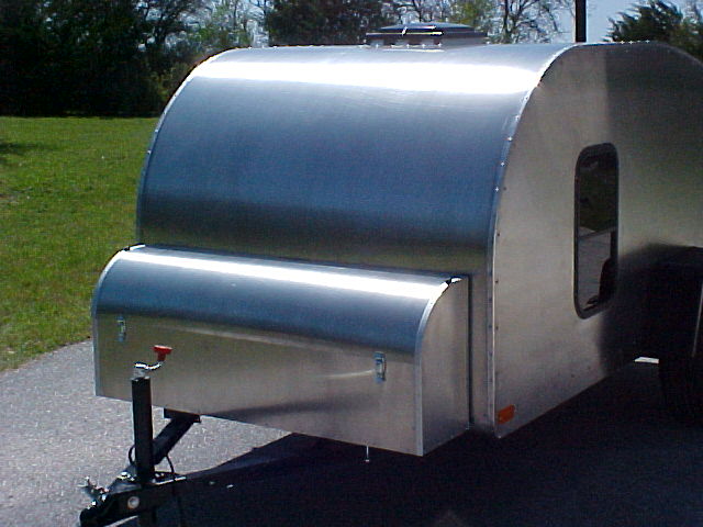

Postby SteveH » Sun Mar 27, 2005 3:53 pm
Here's a picture of the box I just finished and installed. It's big enough to hold the awning, folding chairs, door mat, water hose and extension cord.
