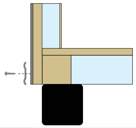

My side walls overhang the frame and the plywood end grain is exposed, so I want to seal the end grain with epoxy so no moisture can get in. I don't need a lot, so my question is if the epoxy sold in smaller tubes as an adhesive is the same stuff used for fiberglassing, and can I use it for my purpose.

Dean, another way is to screw from the underside aluminum channel on the bottom edge of your walls with a heavy bead of your sealer in between . It gives a nice finished edge. That's the way I did my 2 tears. :) Danny

halfdome, Danny wrote:Dean, another way is to screw from the underside aluminum channel on the bottom edge of your walls with a heavy bead of your sealer in between . It gives a nice finished edge. That's the way I did my 2 tears. :) Danny
That's a good idea, but I think I'm past the point where I could get channel on there. :(
The best I could do at this point is angle. I actually thought about using angle, but I didn't want to create a space where water could get trapped if my sealing job wasn't 100%.
I already have the original style side trim that I'll be using. Besides, you won't be able to see the bottom of the plywood unless you're laying on the ground. I'll just epoxy the heck out of the bottom edge, seal the gap between the frame and the body with goop and keep my fingers crossed.
