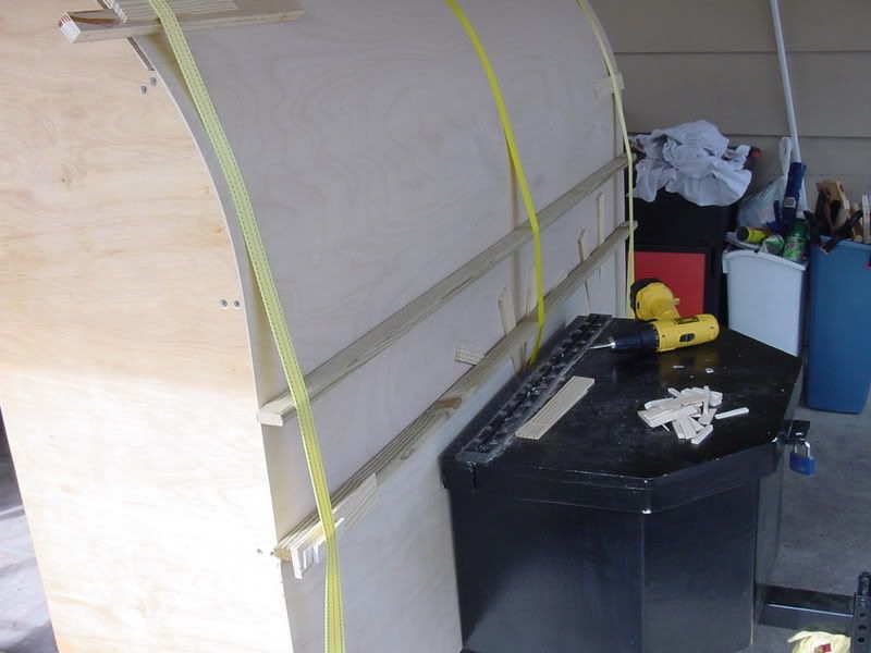

Postby Mary K » Thu Sep 25, 2008 2:49 pm
I had 2 layers of skin. The first was luan that I glued with Titebond III and stapled to the spars. Then on the 2nd layer of birch I used PL construction adhesive and sand bags to even the weight distribution. I skinned the hatch before I attached it to the TD.
The TD 2nd layer went on with PL glue and 3 ratchet straps and shims.
I did one section at a time.
Good luck.
Mk

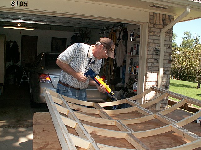

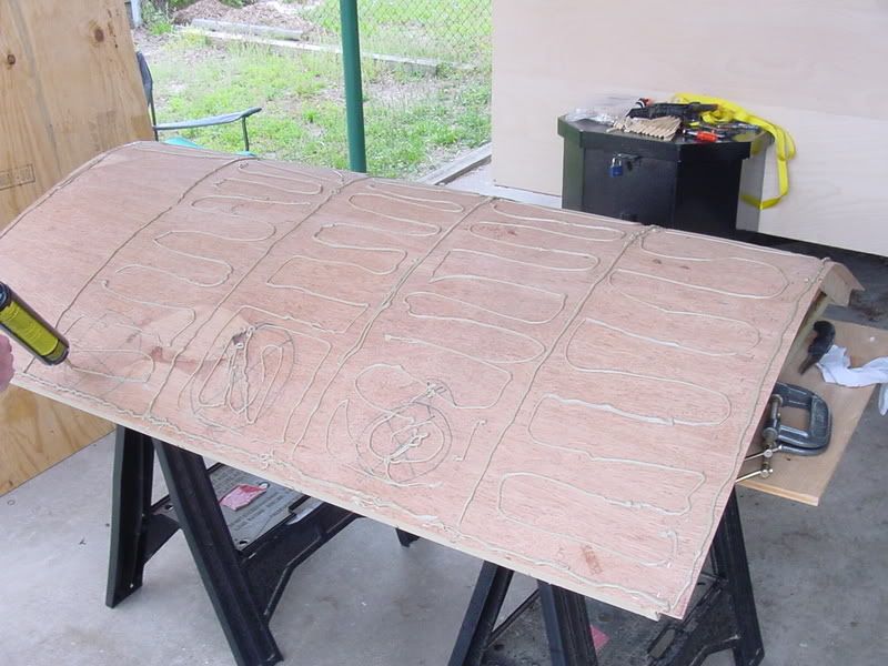

Postby Toytaco2 » Thu Sep 25, 2008 4:03 pm
I used PL Premium (polyurethane construction adhesive) for exactly the same reasons as Dean A. If you cut your vertical frame members from 3/4" ply as I did, its not that easy to get a perfectly uniform surface for gluing the plywood face to. The construction adhesive helps a little with this. IMHO the glue on the 2x2 hatch cross braces provides the best surface for the glue. Also, the construction adhesive gives you a little more "open clamping time" than the wood glues which is very helpful on this job. Here I was applying the glue for the interior skin. It came out rock solid.
Good Luck,
Mike

Postby Arne » Fri Sep 26, 2008 10:39 am
though the type of glue is/may be important, the best thing is to run a shim/cleat across the top and bottom (and maybe straps) to hold the top and bottom edges in place until the glue is thoroughly dry/hard.
If you do that, the rest will normally stay in place. In my case, I screwed the top and bottom cleats in position. After the titebond II set up, I removed the screws and cleats and filled the holes... my tear is painted, so the filled holes were not a problem.
