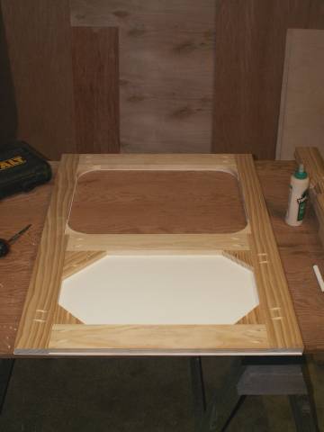

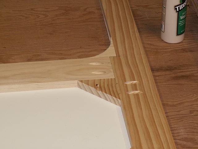

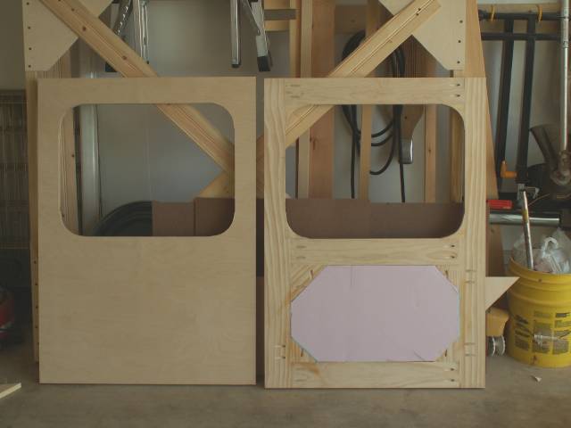

Postby Toytaco2 » Thu Oct 09, 2008 6:51 am
Its not a very difficult job. Just be sure you have suffiecient internal support for hinges, window frames, and whatever handle/latch setup you use. Hope these help:
Notice this last pic shows a little bigger corner/diagonal brace in the left corner right under the window opening because this is where the handle/latch will be located for the passenger side door.
Good luck!

Postby Juneaudave » Thu Oct 09, 2008 8:59 am
Jess...most builders use the same construction on the doors that they did on the walls..that way the doors are the same thickness.
Whatever you do:
    1. Make sure you have reinforcement for the hinges and handle
    2. Seal the edges good, I used epoxy
    3. Assemble on a flat surface so you don't get an inadvertant wow in the frame
I had to redo a door because of Number 3 when assembling with pocket screws.
