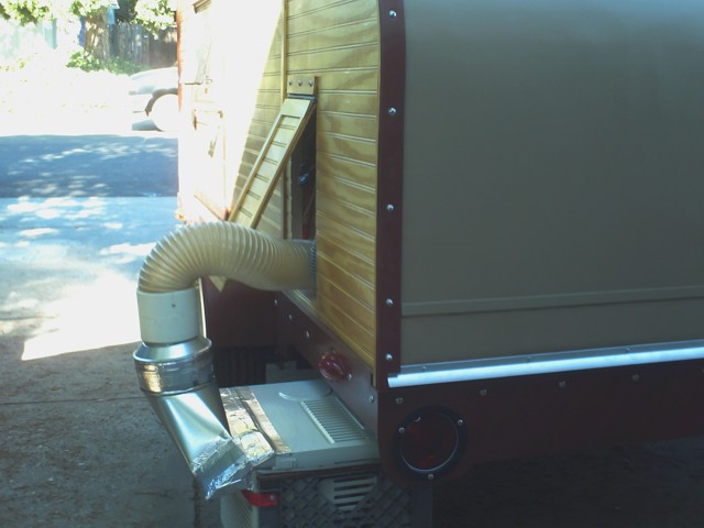

Postby satch » Sun Oct 19, 2008 9:27 pm
I have an access door on the side of mine, for the elec. box and storage. I just leave the ac outside, hook up a 4" flexy tube, and it goes through the foot board inside.

Postby 2bits » Wed Oct 22, 2008 4:49 pm
satch wrote:I have an access door on the side of mine, for the elec. box and storage. I just leave the ac outside, hook up a 4" flexy tube, and it goes through the foot board inside.
as much as I don't care for the external AC's I think it is very inventive to use that milk crate as a carrying case!
