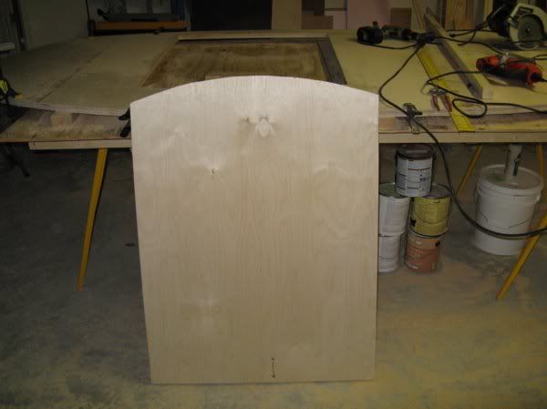

Postby planovet » Mon Oct 20, 2008 6:17 pm
Something like this maybe? I don't know the radius I used. I just put a nail near the bottom of the door centered on the center line. Took a string with a pencil, pulled it tight and went from one top corner to the other. Just move the nail up or down until you get the radius that you want. The closer to the top you are the more of a curve you will get. I think my nail was near the bottom of the door if not below it (I traced it out on the side before I cut it out).

Postby rhltechie » Fri Oct 24, 2008 10:37 am
Thanks Mark. I was messin around with a beam compass the other day trying to get a radius I liked, still havent found just the right one yet!

Postby planovet » Fri Oct 24, 2008 11:01 am
No problem. I just used a string, a nail and a pencil. Just move the nail up and down until you get the arch you desire.
