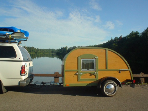

One part attaches to the table, the other to the td. I rounded off the edges on the outer tear and I'm real happy having these extras.....if needed. You can see a small silver bracket in my side profile. It comes in a 30" length so I cut it into 3 equal sizes.

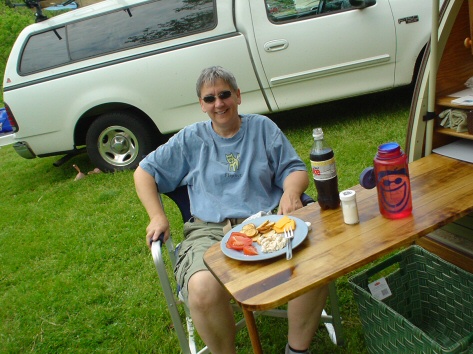

I bought really nice aspen from Lowes. Here's a closer look at it. That's me all smiles from my first outing with the teardrop.
All the widths are 18". The side tables are 3' long and match the counter height. The table to sit at was 4' because a foot of it was under the counter.
Some folks have cut out room for a bowl or a sink. There's no limit at what you can add for comfort. If I have a long leg to travel and need to stop at night the the tables are stored in the back of my pickup. If it's a same day drive I slide them in the cabin on top of the mattress.
