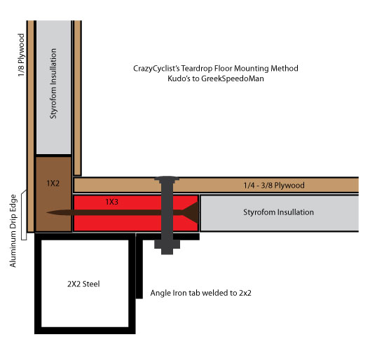

Postby crazycyclist » Fri Dec 05, 2008 5:32 pm
Thanks for all the ideas! :applause:
After reviewing these plans and consulting greekspeedoman and the jPod, here's what I'm looking at doing. Any ideas and suggestions are welcome.

Postby planovet » Fri Dec 05, 2008 6:19 pm
Looks like the bottom edge of your exterior ply is exposed that way. Make sure it is sealed really, really well. Or just put the whole thing even with the edge of the 2x2 steel and cover the edge/seam with some trim.

Postby 2bits » Sat Dec 06, 2008 12:44 am
My first thought is that it looks like you are considering 1/4" plywood with nothing underneath besides the insulation. I'm not a huge guy, but I wouldn't go less than 1/2" for the floor, that's what I am using and it is fine. 1/4" is not going to be very strong in general and especially considering the off road factor too.
Also the screw seems like it might make a better joint going left to right rather than right to left since you've got trim going over it anyway.
I used a carriage bolt that went through my floor and through both walls of the 2x2 frame. I used lock nuts and I will check em, not sure if that is a terrible idea or not. (The wood on the side just overhangs the side of the frame, the bolt goes through the frame.)
Thomas
2bits
2bit Member
Posts: 5132
Location: Lake Tawakoni, TX
Postby Esteban » Sat Dec 06, 2008 2:48 am
I used 3/8" plywood for the top layer of the floor, over a 3/4" wood frame and insulation, with a 3/16" luan plywood bottom. It's plenty strong. The inner wood floor frame looks like a ladder. There are wood cross supports on approx. 2 foot centers that line up above each of the 2" x 2" steel angle cross pieces for floor rigidity and so there's solid wood wherever the floor is bolted to the trailer frame.
I question whether using 1/8" plywood for the outside walls is rigid and strong enough, particularly for off road use. I used 1/4" plywood outside, over a 3/4" wall frame and 3/4" insulation, with 1/8" inside plywood. It's very rigid. I've fiberglassed the sides and will fiberglass the roof and hatch when I get to building them.
Don't know how strong an off road trailer frame needs to be. For mine I used 2" x 2" x 1/8" tubing for the outside frame. It has 2" x 2" x 1/8" L shaped inner cross members on (approx.) 2 foot centers. Except at the corners, where there are corner gussets, the floor is bolted to these cross members. There are no holes or penetrations into the 2" x 2" tubing hoping that will deter them from rusting. I countersunk the bolt heads into the floor and filled the holes in the floor with epoxy.

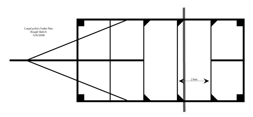

Postby crazycyclist » Sat Dec 06, 2008 7:47 pm
Thanks for all the tips, questions, and suggestions.
I'm not skinning the bottom as I want it to be able to dry out if it get's wet. With an offroad trailer, crossing a creek is not out of the question. The plan is to seal the bottom with several layers of undercoating before installing the insulation.
I too do not want holes in my 2x2 steel frame thus the option of the tabs. I may actually bolt through the corner braces. I'm planning on 2x2 for the outside from and tongue with c-channel cross members every 2 feet. I'm also planning on a 2x2 receiver at the back for a bicycle rack. I may put some 1 1/4 receiver at the side by the galley for optional extensions such as tables, etc.
I'm planning on sealing the joint surfaces with epoxy. I may bring them in as well. Still thinking on that one. Thanks for pointing it out.
I've heard of problems with screws working their way out and damaging the skin - thus the idea of screwing from the inside.
Here's a rough sketch of my trailer plans. I just dropped an axle in "about there". I'll get that more accurate later.

Postby 2bits » Sun Dec 07, 2008 10:45 pm
Your frame looks plenty tough! I have heard from my friend who is a trailer builder that the farther back the a frame for the tongue goes back to the axle, the more stable it will be, that might be important with an off road trailer.
The angle mounting strips are a good idea, alot of different vehicles use them. I wanted to keep construction as simple as possible and I drilled very small drain holes on each of the four corners to release any water entry, or condensation buildup.
