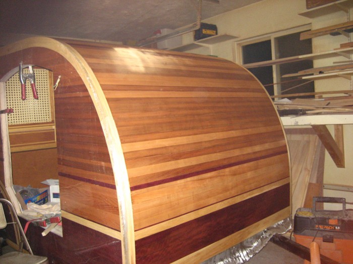

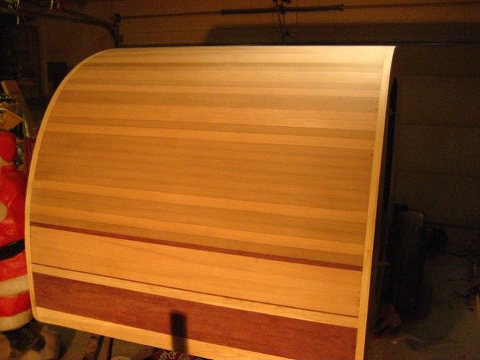

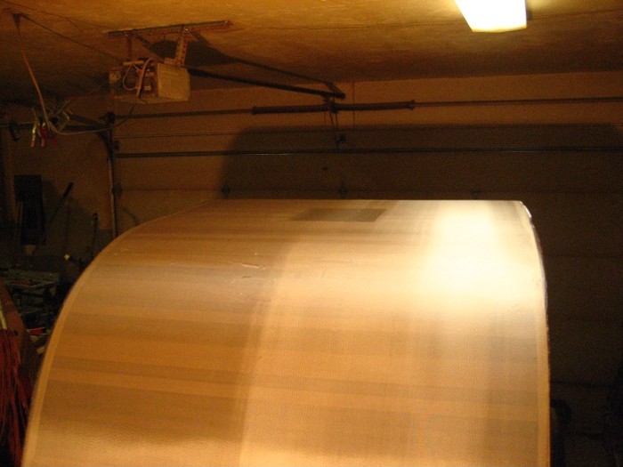

I got the roof sealed today...sanding to 220...
4 oz cloth on....
Wet out coat with MAS Slow...will do fill coat tomorrow!
Uhhh...Not bad for a two or three year build... :roll:

That thing will be as strong as a tank! And a beautiful one at that! Keep it up.

That is beutiful, I so love the woody look :thumbsup:

Image It is of course beautiful! Now where are the how to shots? 8) :D Looks like you stripped the curve just exactly right. :thumbsup:

Thanks guys...I think it will turn out pretty good!!! I put the fill coat on this morning an all the "blotchy look" dissappeared. She's all smooth now...hoping to be ready to apply the battens and round the corners like the hatch over X-mas!!!

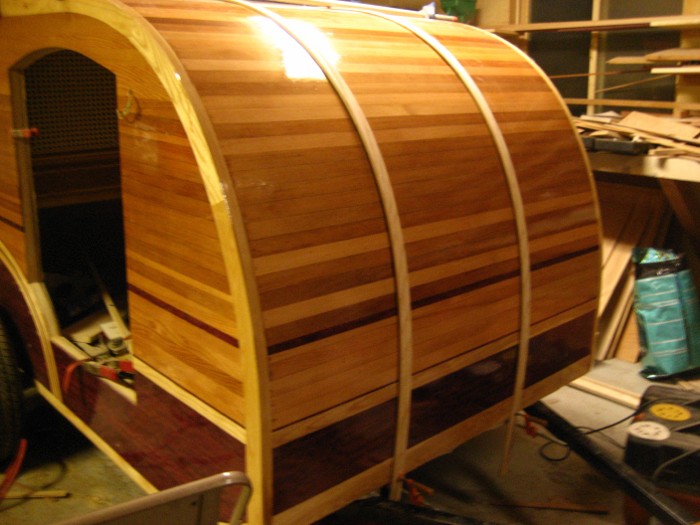

Always loved your build, that is true craftsmanship! I like the two wood runners across the middle on the hatch, are they going to continue over the roof to the front?

Thanks Thomas...I steam bent the two inside battens yesterday and am letting them dry. Tomorrow, I'll mount the hatch so I can "eyeball" it so the inside battens line up. Like the hatch, I'll bend two more stips for the outside and roundover the edges to 1 1/2 inch. Unless I screw up with the router...ought to be skookem!!!
