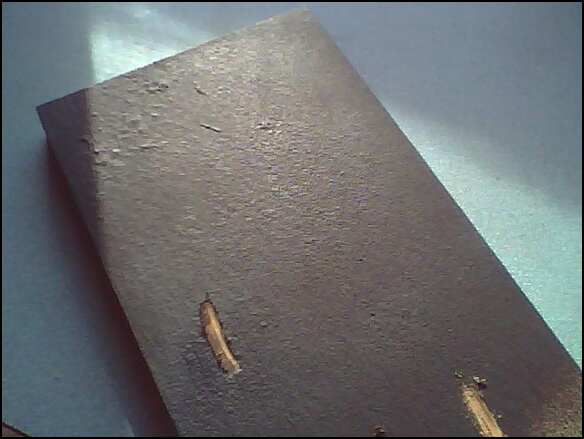

Postby bbarry » Fri Jan 02, 2009 11:31 am
Thanks for the replies! Sounds like this may be an okay way to go. Here's a shot of my test. This is one coat of spray undercoating, dried 24 hours. As you can see, it scrapes off with a screwdriver so it's not terribly abrasion resistant, but I'm not too worried about that...it's not going to get much in the way of physical wear.
I think the key (as with paint) may be multiple thin layers to build up a little depth.
