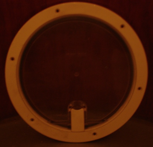

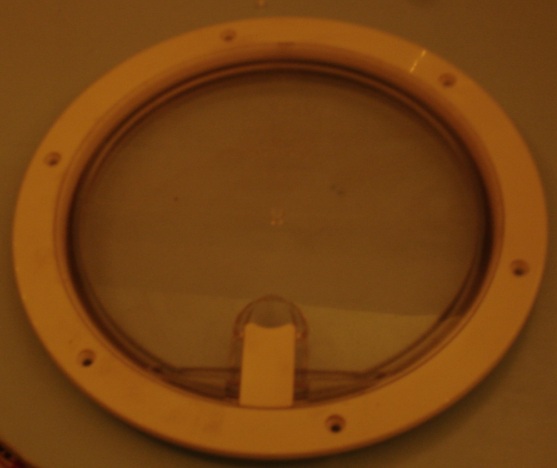

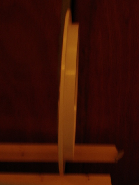

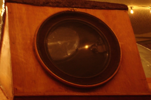

Postby Todah Tear » Sun Jan 11, 2009 11:07 pm
DavidnMartin,
You might consider using clear deckplates. I used them for my galley rear window and skylight on Todah 1. You can get them as large as 10" frame(8" clear window). The mounting insert is 1/2". Because they are designed to keep water out of areas under the deck of a boat, they are designed to be water tight.
Here are some pics of mine:
Galley
One not installed and the Image
Profile of mounting insert.
I might add that the pic of the one installed as my rear galley window has a black mesh screen that I made over it in the picture. The viewing plate is clear, but not tented. The white lip goes on the interior of the tear because you want to be able to use the pry lever to open the window. Deckplates can be purchased with the "screw open" design as well.
Not expensive, very easy to install and they provide sufficient visibility.
