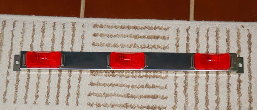

The next link is to a store and pictures the center rear ID lights they sell. It appears the 3 lights are generally mounted on a bar on six inch centers, installed on the trailer "rear, center - facing rearward - horizontally and as high as practicable". On a boat trailer that would be on the frame below the boat. For a teardrop I am not sure.

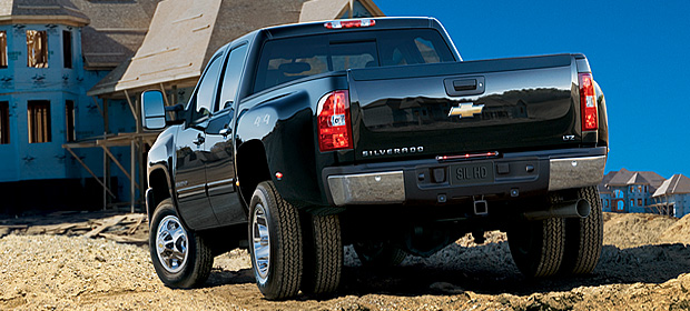

Chevrolet did it this way on the 2009 Dually Silverado. The center rear identification lamps are just above the bumper/license plate with clearance lamps on the rear fenders. The new Ford dually is about the same. I was a little concerned about how it would look to have the three lights above the license plate. But now I think it looks good. I would put the 3-light bar where my plate mount/integrated light is now and mount the license plate about 2 inches lower, with power source the same for both.

Found this picture online. I am trying to get a ruling from NHTSA on any 80" wide lamp requirements for a teardrop including location and height. In the absence of any official new info I plan to put an ID lamp bar on the rear above the license plate. This is a case of conflicting requirements, "on the rear and as high as practicable". I think we can always say "to put them any higher would not be on the rear". Teardrops 80" or more wide are unusual enough that troopers probably will not bother us if the rear ID lights are on top, on the rear or none. :thumbsup:
Bill

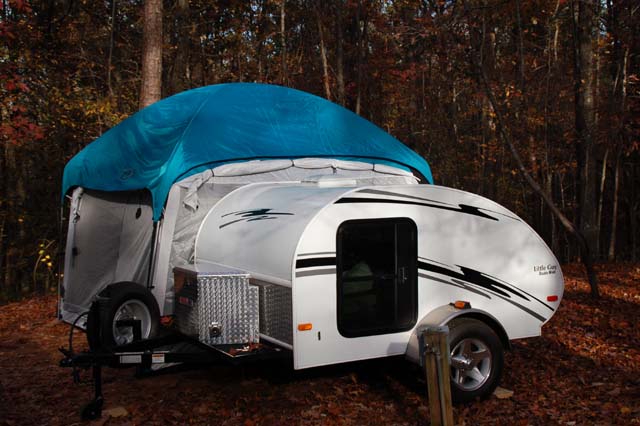

Digressing a bit, the photo was taken on a cold morning near Columbus, GA. During the night Paige, our camping kitty, got out of the tent. When Patricia woke up later and discovered her missing it gave us quite a scare. We were very thankful to find her in the woods nearby. :worship: She seemed happy to get back into the trailer with us and we have since sealed up a small opening in the tent at the right wheel. The tent snaps onto the trailer around the right door.

My new center rear ID lamp bar came via UPS today. It is Wesbar brand and comes with the lamps mounted on 6 inch centers on a stainless steel housing. Now I will soon be a legal beagle. 8)
The light bar is to go where the license plate light/bracket is now and the license plate will be mounted about two inches lower. I'll add a pic of the completed installation.
