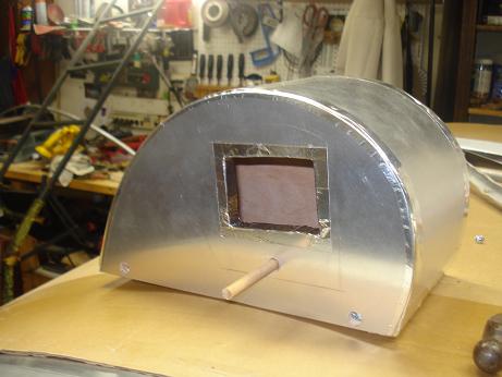

Postby prohandyman » Sun Jan 25, 2009 9:05 am
Conbrio
I made a couple of bird houses out of left over aluminim from my KIT rebuild. But, I had considered using aluminum flashing from the hardware store, sold for roof repairs on homes. Comes in colors, on different size rolls, easily wide enough so that you would have no seams, except for where the top meets the sides. I used aluminum tape cut real narrow to fabricate an edge trim. This tape is also found at hardware stores for use in sealing heating ducts.

I would avoid placing seams and penetrations where water may have a chance to pool.
For edge trim, install in a solid piece over the top, no seams on the roof. I would bevel a slight overlap on verticals and fill with a waterproof sealer, like used for gutter flashings.
For sheet skins, again, I would seam on verticals, overlap sheets with a sealant between layers, and fastners installed at seams. Remove screws once installed and put sealant in the holes too!
