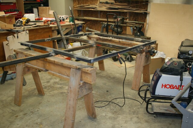

Postby Steve Frederick » Sun Feb 01, 2009 4:17 pm
Frame steel cut, mostly welded. I ran out of wire for the welder.
I'll hit Tractor Supply on the way home tomorrow night.
I was going to narrow the 58" Flexride axle I have. Decided to leave it alone, since I'll be selling it. I don't want the new owner to have a problem, if I mess it up.
So, I'm moving ahead with a 5' wide version of Peg's trailer.

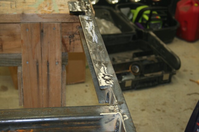

Postby Steve Frederick » Sat Feb 07, 2009 5:36 pm
Ok, I got stalled out..ran out of wire for the welder.
I finished the welding today.
The frame is 5' wide, and 6' long.
I did the side rails in 1-by-2-by-3/16" c-channel. The steel was left over from Peg's project.
The Cross members and angle iron body mounts were left overs from the 'Rondack.
The axle was in the shop. I originally got it for the 'Rondack, but went with a #3500 axle. (For the brakes). This one won't need brakes, so I used the #2000 Flexride that I had.
I made a wider perch for the axle with a second section of C-Channel.
I'll clean it up and paint tomorrow.
