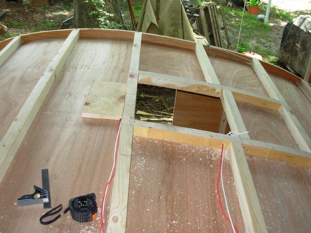

Don't have any pix of the actual Fantastic Vent/Fan installation but here's a couple of pix of the 'radius' framing for the vent & the insulation prior to adding the roof skin. Not a lot of 'curve' but you can see it is definitely there. Installed the vent with nothing more than sealant & screws. 2 1/2yrs & almost 10K miles later there've been no leaks or any other problem.
