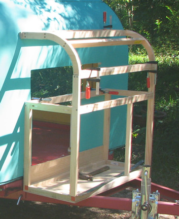

I still haven't managed to get my build pages reloaded, but here are a few pics of my tongue box build...I think it's the only part of the tear with more new material than salvaged pieces, LOL!

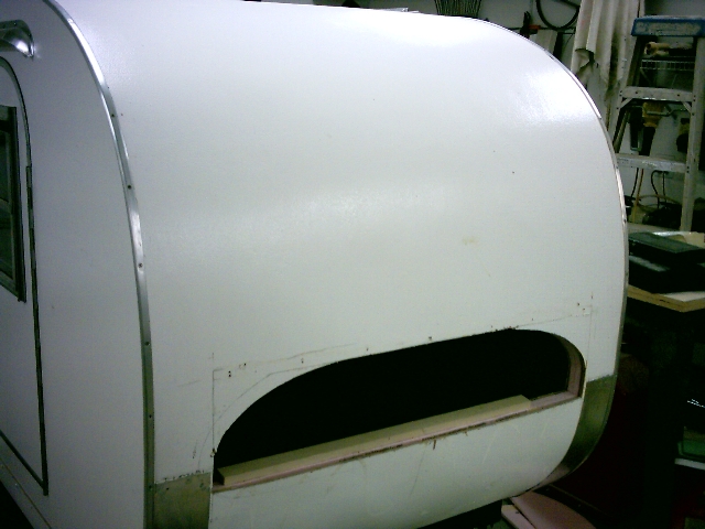

How the 'inside access' was framed:

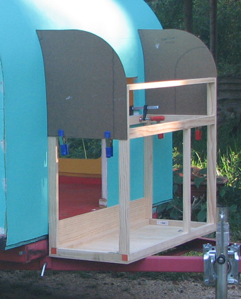

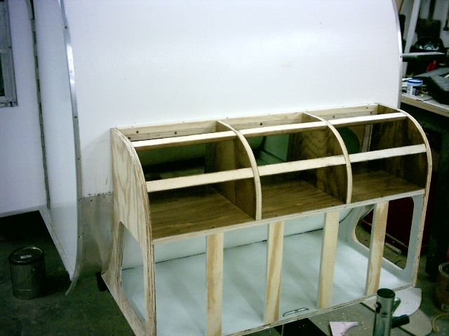

Assembled the basic framework in place on the tongue, made a template to match the curve of the body, then cut and framed the roof supports:
Moved the framework inside to skin, paint, and build the doors:

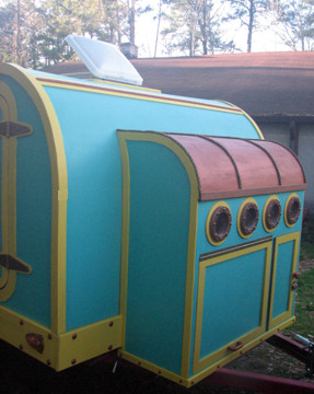

Reinstalled...it's bolted to the tongue and also attached to the body:

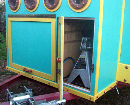

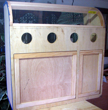

It has three separate compartments...a large domed interior shelf, a large compartment for the air conditioner (or extra inside storage when the a/c isn't needed), and a small outside storage area for extention cords, wheel blocks, jack stands, etc...:

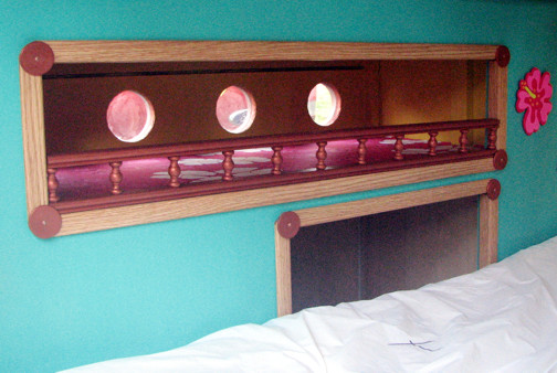

The inside shelf isn't finished yet...I have small porthole covers for the windows, rope trim for the edges, and a grass mat headliner for the roof that needs to be installed:
