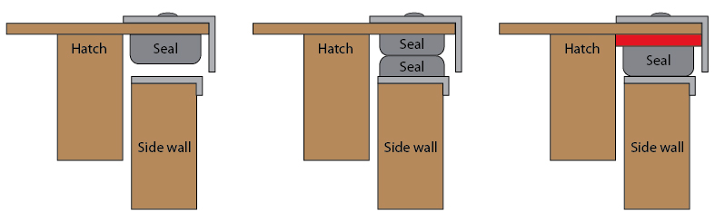

I ended up using stair nosing from Home Depot. It was dead-soft and the short side has a nice soft radius. I attached it with an aircraft rivet tool I borrowed from a buddy of mine.
And just to be clear, I ended up going with the third option in my diagram. I found that the gap was a little wide, so I cut a thin strip of ply and inserted it where I show the red area on my diagram.
