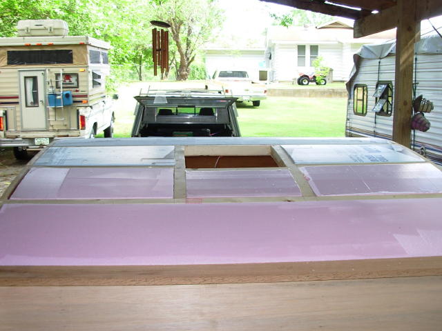

Depends on wall construction type. Don't have any experience using solid plywood walls. I used 'sandwich' wall construction. Cut my profile from 1/4" oak ply (stained/poly'd inside before installation), added 3/4" framing cut from 1X spruce, installed sides on floor, installed 1 1/2" spruce spars for roof then installed ceiling, filled all voids with 3/4" foam board on sides & 1 1/2" foam board in ceiling & front before adding 1/4" luan sides & double layer of 1/8" luan on top. Have a fantastic vent/fan in roof & 12X18" crank-out windows in each door for ventilation. Have slept comfortably with only light fleece sleeping bag & comforter down to 18* with no heat. The fantastic vent & door windows open a couple of inches keeps enough air moving to sleep comfortably in high 80's/low 90's unless it is very humid, then I hook up the Pet Cool AC.

Blue.Pink. White. Doesn't matter what type but does doesn't matter what R-value . Pick the foam with the highest r-value. The pink and blue foams are less of a mess to install than the white type. The pink and blue are extruded poly, the white is not. Hence the white snowstorm you get when cutting it.
Either way I cut foam on the tablesaw- quick and easy.

Used pink foam in the teardrop walls, floor and ceiling and a Fantastic Fan to circulate air.

I dont have insulation on the sides as its 20mm Marine ply however I used 50 mm blue insulation from front to back and Im glad I did. Its nice n warm in winter and cool in summer. In addition Ive got the Fan Tastic Fan above. ;)
Next time I,ll insulate sides on our next tear. ;)

I'd recommend insulating the floor for extremely cold weather. I know a mattress can provide insulation, but the cold can come through it as well.
I used a built up floor, just like my walls and ceiling... it came out weighing about the same as a 3/4" ply floor would.
Other than that, same as above. I have 4 smaller windows and a fantastic fan in the roof.
