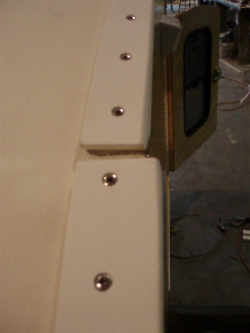

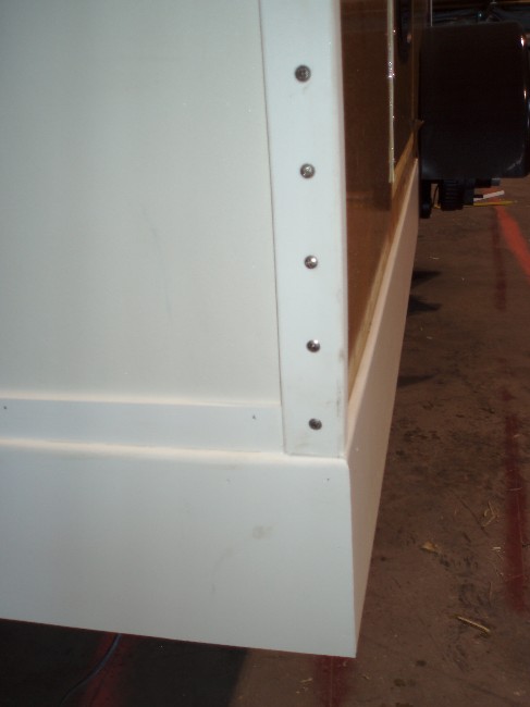

Marty, I used Azek poly-trim it comes in white but is paintable. I rabbited it my self and predrilled for ss screws. you can also glue it together with a product like pvc cement. You can also install it using its own epoxy.

I wonder how much Coroplast is a sheet? maybe I would use a batten strip method of securing the panels to the frame. In my previous post you might be able to see how I predrilled and countersunk for SS screws, so you could screw through the Coroplast into the frame, at each frame member, it would be quite light. the batten could match or contrast the panel colors. (don't know about the UV deteriation though) Walt
