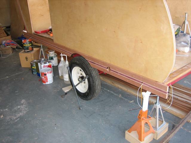

I've used the water based aniline dyes on both boats and tears. If you start with a darker wood, in my case mahogany, it works well. On my boat, I dyed up mahogany in a dark walnut dye on the covering boards with a colonial red deck field. Worked great...same on my tears. colonial red on a mahogany. I did cover them all with about 6 coats of UV resistant epoxy and then top coated it with 2 of auto clear. The water based dyes are more UV resistant than the alcohol or oil based ones. If you want to use the dye as a tint in a finish...my experience is that it will tend to hide a lot of the details in the wood grain. Think about it....you are putting a tinted covering on top of a wood. In a way, it's sort of like a thin paint. I don't know what you want, but I was looking for that vintage Chris Craft boat deck look on a tear. A finish that looks really deep.
They say the dyes aren't exterior approved. Well, they might not be as resistant if you leave it out in the sun 24-7 all it's life, but I do cover my stuff up when not being used, so it's held up well for me. The boat is 5 years old, the woody tear I still have is 4 and they still look great. Haven't had to do any finish touch up on either. Thing is...you gotta make sure you get them covered with UV protectant very well. I think it will be more difficult if you are trying to do a very dark color over a very light wood however. Oil based dyes/stains aren't recommended if they are going to be top coated with an epoxy system. I talked with the tech staff at West and they indicated that I had taken the right approach on what I was wanting to do. Others opinions may vary.
The following pic is of the same material, but with the aniline dye on it, really makes the dark brown look like a walnut, the more you put on...the darker it gets, easy to doctor up colors using the dyes....Doug
