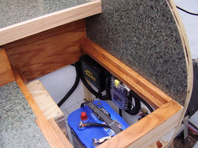

Postby Larwyn » Thu Mar 26, 2009 7:27 am
This how I have mine. The trailer has been connected to AC power and maintaining the charge on the battery for a couple of years now. Even though the trailer has yet to be finished, it has served continuous duty as temporary dry storage for tools and material during this and other projects (right now it is fencing supplies and material for the wife's garden fence) so the lights, fantastic vent and even the Air Conditioner have seen use comparable to several weekend camping trips. I am not recommending that you do it this way, only showing "something that works". It is a very convenient "job box" with lights and climate control for now, once the mattress is inside that will not be so.

Postby planovet » Thu Mar 26, 2009 8:49 am
Larwyn,
How does the Battery Tender keep the battery charged if it isn't hooked up directly to the battery terminals? I'm looking to do mine in a similar setup as yours.

Postby Larwyn » Thu Mar 26, 2009 9:03 am
planovet wrote:Larwyn,
It is connected through a fuse on the fuse block. Here's a simplified block diagram showing the charger connections. It just seemed like a cleaner install without all that excess wire and inline fuse. I"ve spent much of my working life trying to make unruly wires less so...... :lol:

Postby planovet » Thu Mar 26, 2009 9:23 am
Thanks Larwyn! :thumbsup: I thought that was how you did it but I wasn't sure it would work that way. I'm a vet, not an electrician :lol:
I'm going to have the battery and tender in the tongue box and the fuse box will be in the galley. I guess I will just hook it up directly to the terminals.
I know I need an inline fuse from the battery to the fuse box but do I need an inline fuse from the tender to the battery too? :thinking:

Postby Larwyn » Thu Mar 26, 2009 9:48 am
planovet wrote:Thanks Larwyn! :thumbsup: I thought that was how you did it but I wasn't sure it would work that way. I'm a vet, not an electrician :lol:
I used an auto reset circuit breaker between the battery and and the fuse block (the little metal box with two terminals and the #6 cable on both, on the right side of the bottom pic). The battery tender comes with an inline fuse in the positive lead, since I was going through a fuse in the fuse block, I eliminated that inline fuse when I cut the leads to length.
In your case, I'd probably just bundle the leads up and leave them full length, leaving the factory supplied inline fuse as it is. :thumbsup:
