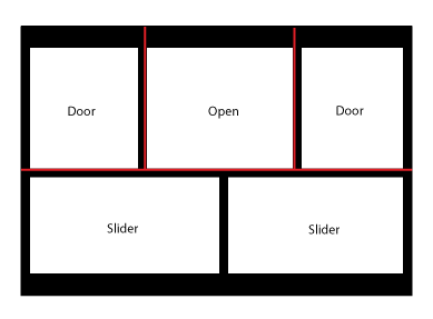

Postby crazycyclist » Fri Mar 27, 2009 9:44 am
Hmmm... Thanks for the suggestions. I guess I wasn't clear enough in my question (Shouldn't write at 1am :? )
I've got a rabbet already for attaching the faceplace to the teardrop walls. The question is now to attach the cabinet wall dividers to the faceplace.
Let me illustrate...
Here is my cabinet design. The red indicates where I want the cabinet walls to go. They will be 1/4" oak plywood. I would like to have them as flush as possible to the open space.

Postby madjack » Fri Mar 27, 2009 10:04 am
I used aluminum angle as cleats for this job...1/2 or 3/4 x 1/16th, scuff up the back, and used gorilla glue and screws to attach...if you click the WWW button under my post, and look at the "galley 1,2,3" and "glue_screw" albums, you will see pics of this...since you are using 1/4ply for dividers/floors, you will almost havvta use some sort of cleat arrangement, since the 1/4" ply is too thin for biscuits or pocket holes.....
madjack 8)
Posts: 15128
Postby bobhenry » Fri Mar 27, 2009 10:46 am
Being a wood kinda guy I would cleat behind your frame.
The horizontal board appears to be about 1 1/4" wide so cut a cleat 1" x 1" attach at the rear and glue and screw from the rear so as not to penetrate the face. use a small piece of your 1/4" liner to make sure you are flush with the face frame. This will hide the raw edge of the 1/4" plywood liner. Prior to installation if you dadoed the underside of this cleat with 2 1/4"+ groves you would have the tracks for your sliders as well.
The uprights look to measure about 1" so use 3/4 x 3/4 rips and apply the same being sure the 1/4" plywood edge is hidden. Glue and brad nail the liner to the cleats.
The only other option I see is to glue and pin nail the liner to the inside face cutting away the 1/4" where it interfers with the face frame and then to cover the rough edge showing by trimming with that small "L" shaped corner trim.

Postby Miriam C. » Fri Mar 27, 2009 7:20 pm
:thumbsup: Wood cleats. If you look at Steve F's last build he has really good pictures of how he did his in the galley.
If you rabbited out 1/4" ply I would also add some blocking behind it. Just me. 8)

Postby Mark McD » Sun Mar 29, 2009 8:58 am
Biscuits may be hard to line up and may make your glu-up a real nightmare. Could you pocket screw the cabinet framework to the sides from behind?, i.e. inside the cabinet compartment?
