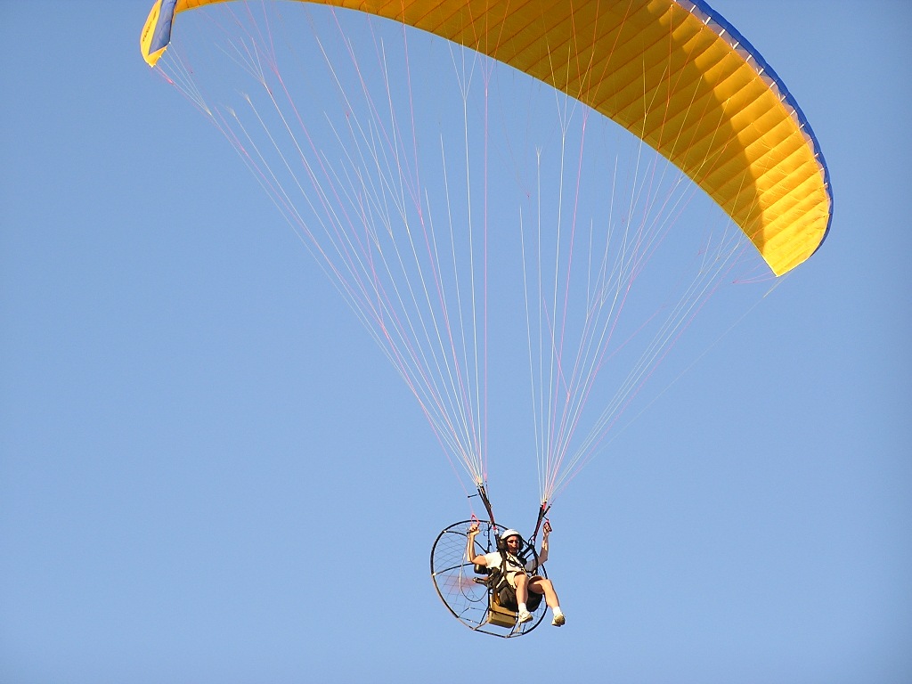

Here's a picture of the motor. The wing gets stuffed into a stuff sack.

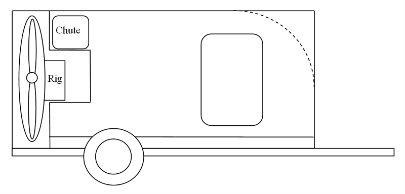

Postby kennyrayandersen » Wed Apr 22, 2009 11:50 pm
You may not be able to get a tear shape out of it, but the concept is certainly workable. Start with a square box. Put the rig in the back 2 feet where the galley ‘normally’ goes and keep the same configuration as a standard galley at the bottom which is only 12-18 inches in depth It looks like it would be a pretty tight fit at 2 feet, but I’m guessing that the seat either removed or folds up. It looks like near the bottom of the fan that there is only the fan, which is thinner. That should allow you to Put a cubby hole in it to make the bed longer and likewise doing the same thing at the top gives you a place to put the chute on the inside. You can tweak as required.

That's why I moved the doors to the side and left the compartment for the powered chute in the back. I don't think you want to sleep next to fuel. With doors on both sides escaping would be easy and there would be zero chance a getting fumes in the cabin. Fuel could be stored either side of the engine in the same compartment as the engine, so all of the gas is in one place.
I think the other versions that Mike drew would probably work as well because the fuel source (whatever toy) is not in the cabin while you sleep. Still the point about the fuel not being in the cabin is a good one, so for that configuration maybe the extra fuel could be accessed from the outside so that it too is sealed from the cabin? :thinking:
