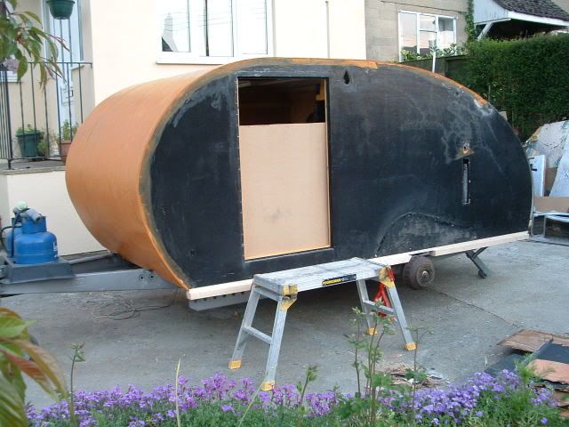

We finished Thypod back in July last year, and had some great fun camping out in it. We didn't know when we built it, that polyester resin was porus :oops: , and noticed some cracking in the resin shortly after having it campable.It seemed worse on the top at the front of the trailer.
I gave the affected area a good coating of gel coat , thinking that would sort the problem out. :roll: :roll:

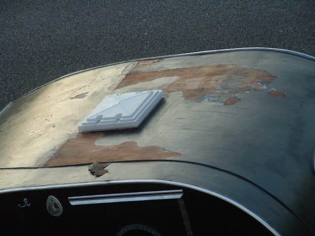

We covered the trailer over winter,but after it's first outing this year, I noticed more cracking, and some bubbling almost like blisters in the resin.

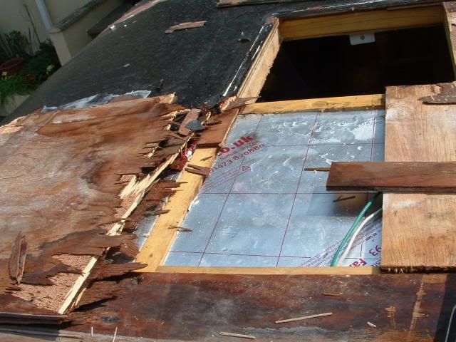

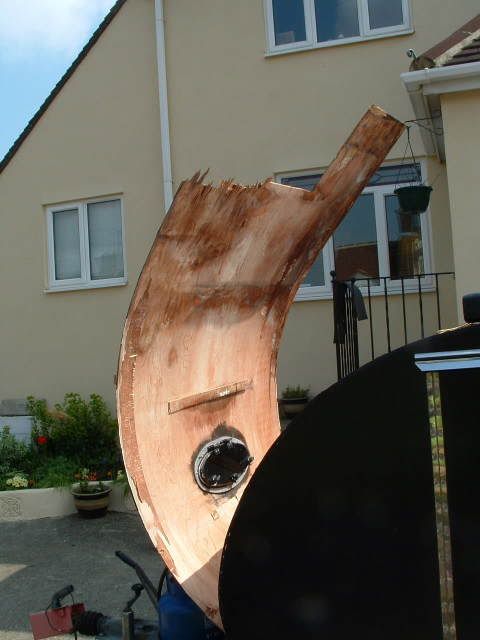

Further investigation showed a large area of the ply was damp under the resin, so I decided the best action would be to replace the ply , and cover the trailer with aluminium.
Here's the photos;
Cracking in the resin
The affected area;

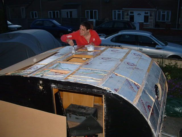

On removing the ply, we found water on the insulation :thumbdown:
We ended up removing the whole roof;
Here's Rosie gluing up for recovering

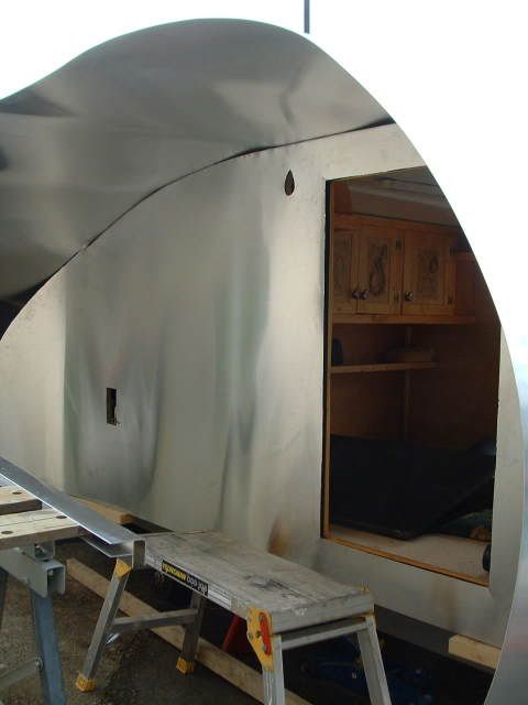

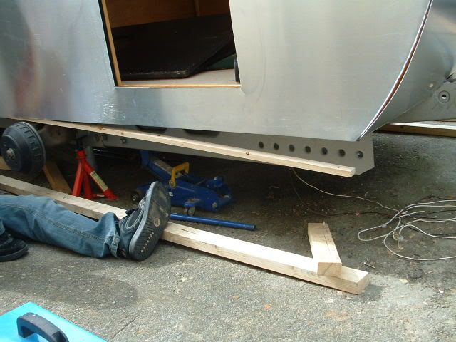

I fixed a 3/4" batton along the bottom, and then a wider piece of timber under that to sit the ali on and make things a bit easier.With the batton removed I could dress the bottom edge of ali around the bottom edge of the trailer;

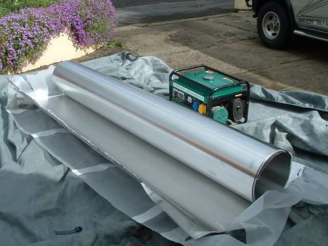

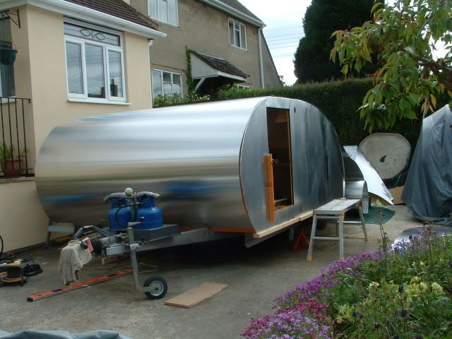

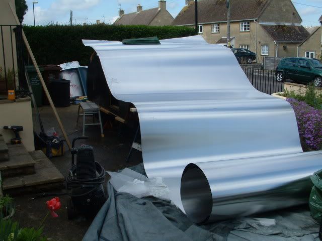

I bought a 35' long roll of 8' wide ali, there was a mix-up with the price, and I got it for £200. It's .032" or .8mm thick
It's not the easiest thing to work with;

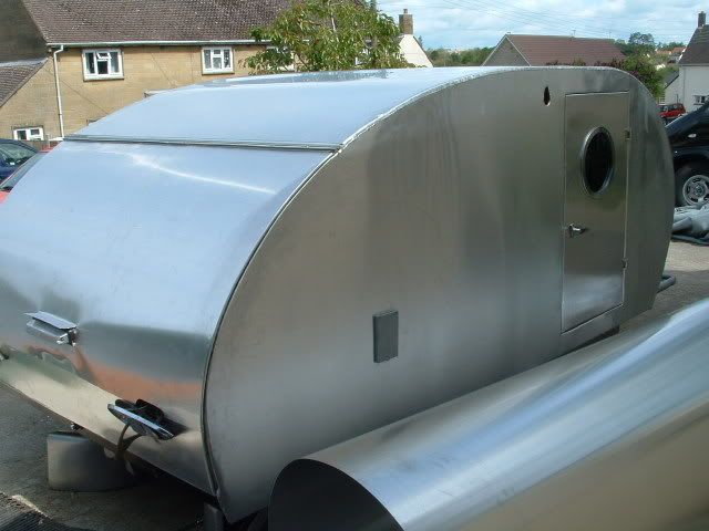

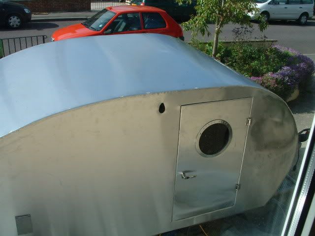

Heres our 8' wide teardrop;
Perhaps we could have a built in porch;

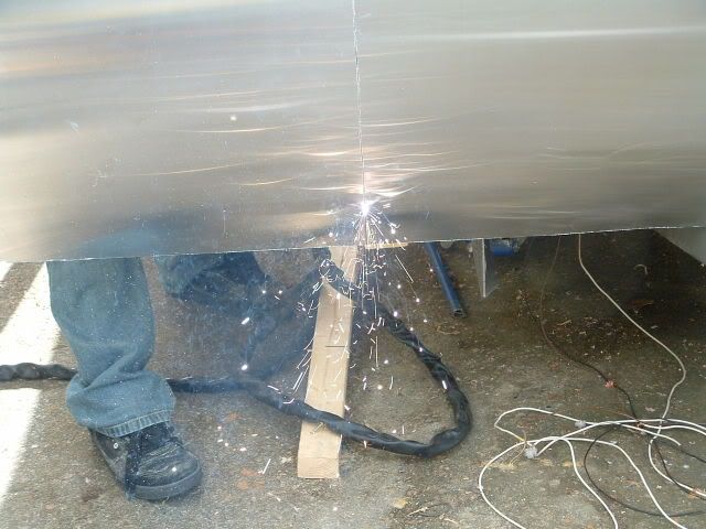

The plasma cutter made light work of it ;
Removing the guide baton

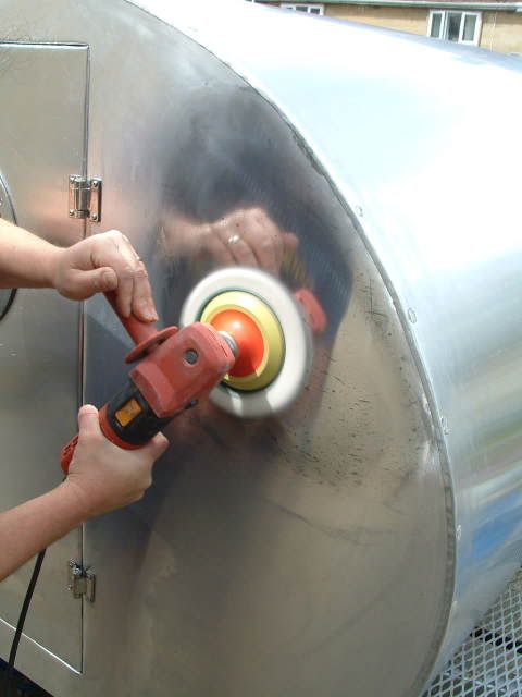

We couldn't resist seeing what it's going to look like polished up;
Here's a view from the top, before we fitted the roof vent
Heres the rear hatch hinge refitted .I've still got a bit of finishing off by the number plate and the rear lights

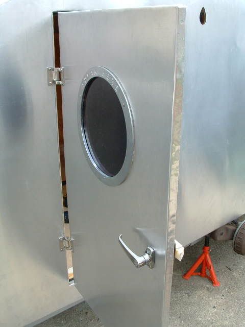

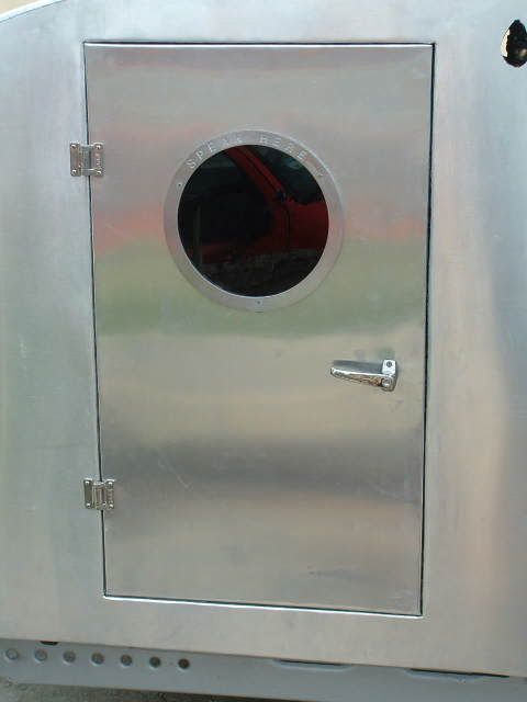

The doors have new stainless steel hinges . The ali has been dressed around the doors , and into the returns;

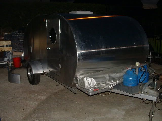

It was dark by the time we finished for the day;
I'm planning on polishing the ali before fitting the trim and weather stripping.
I'm feeling confident the damp is going to stay out now :thumbsup:

Todah, The round windows came from ebay. They must have been used in a counter somewhere, as they have SPEAK HERE marked around the top.
