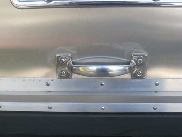

Postby Dean_A » Wed May 06, 2009 11:26 am
I got my draw latches from McMaster (www.mcmaster.com), item #1807A62. They were on the pricey side because I went for stainless steel, but you can get regular zinc plated versions much cheaper. They work great, because the latch distance is adjustable, and they are lockable. I just have a handle on the back hatch, and the draw latches do all the work.
For the catches, I just bent an angle out of 1/16" aluminum flat stock I got from Lowes, then used aircraft rivets to attach the catch that came with the draw latch.
The whole thing works great, and cinches the hatch seal down tight.
