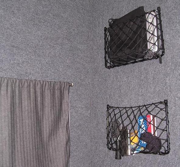

I covered the walls in ours using a light weight automotive carpet (sort of like "speaker box" carpet). I just glued it to the walls and it worked really well and held up wonderfully. It helped keep the trailer warm, cozy and quiet- esspecially when you brush up against the walls while your sleeping. It's also really easy to keep clean - if it does get dirty I just vacuume the walls!
That carpeting looks really great on the walls. It is a great idea. The one problem (and it is a BiG one) that I have is that my wife is severely allergic to anything that has natural rubber (latex) in it. She is a RN and acquired the allergy through long term exposure to latex which is highly used in the medical field. Some glues, carpets, food associated with the rubber tree (hazel nuts, bananas, mangos) etc, have some form of natural rubber in it so we have to research everything that we purchase or are thinking of purchasing. Makes life interesting. That is actually one of the reasons that we decided to build our own camper.
