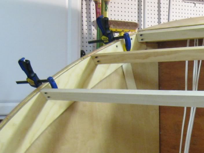

Here is a picture of my hatch spars attached with pocket screws. The spars are not exposed so I didn't care where the holes were.

planovet wrote:Here is a picture of my hatch spars attached with pocket screws. The spars are not exposed so I didn't care where the holes were.
That’s nice and saves you from having to putty all them holes from the outside. :thumbsup:
