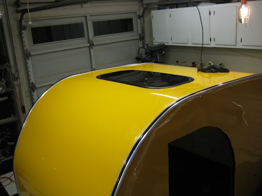

PostPosted: Fri May 29, 2009 6:38 pm
by ssrjim
PostPosted: Tue Jun 02, 2009 9:55 pm
by KDOG
There ya go, thats' what I'm talking about. Do you have any problems like leaks, etc?
I like mine.
PostPosted: Tue Jun 02, 2009 11:52 pm
by ssrjim
No leaks, here it is in the rain:
You will get some condensation from off your body unless you have it or a window cracked.
Here it is with the Sun Screen closed:
