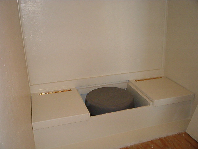

I have been building my trailer , off and on, for about a month now and decided that I would put a portable toilet in it ( just in case). I keep getting told that almost all the campgrounds have toilets and showers. this may be the case, but what happens if I didn't stay at one of those campgrounds? I thought I would share how I did mine incase anyone else is thinking about putting a toilet in their trailer.the toilet is only 20 bucks at wal-mart. The main thing to remember with my trailer is that it is the same height all the way down its length.

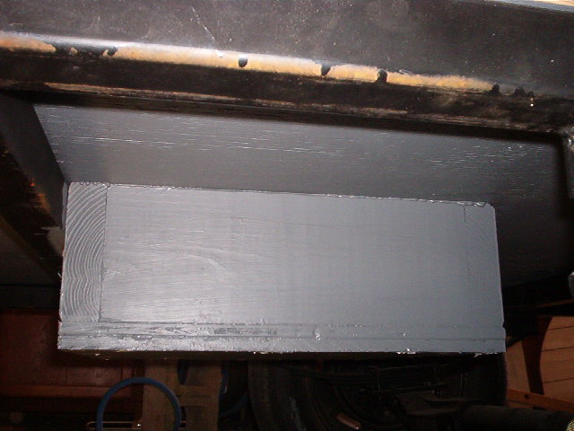

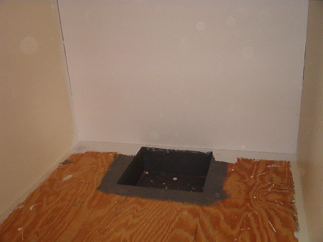

the first picture show the box that I built so I could drop the toilet low enough to actually use it. another thing to remember, I am only 5'5" tall.my trailer is set up so that we will sleep with our heads toward the galley.
Hmmm, looks like I could use some more black paint on the frame too.
this one shows box from the top

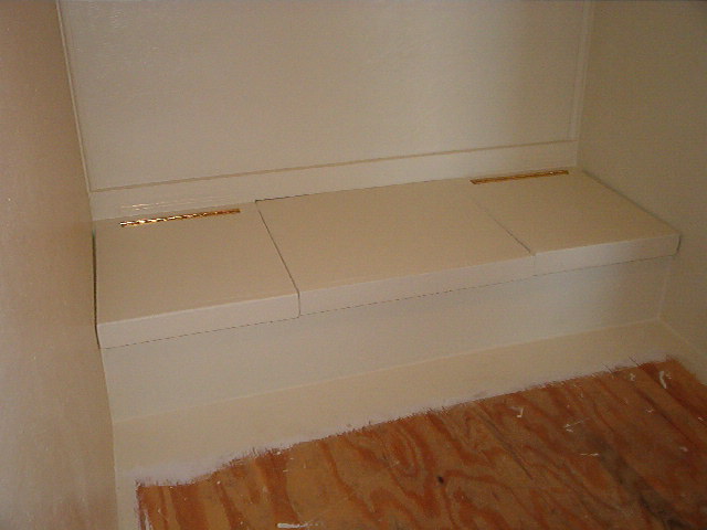

this is the storage cabinet built around the toilet

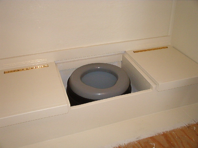

here is the potty
open for business

my floor is 3/4 of an inch and the box is 2x6 material which is 5 1/2" for a total of 6 1/4" this makes the potty stick about 7 3/4 inches above the floor.
