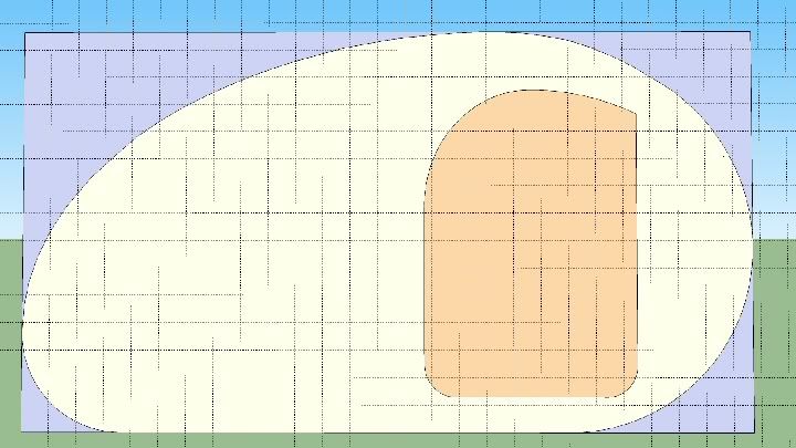

Postby tinksdad » Mon May 25, 2009 1:29 pm
I have quite a few of the different profiles saved in my Sketchup files. It didn't take much to shrink the Ultralight to fit the parameters you stated.
If this is what you are looking for, I can work up the x,y co-ordinates to loft onto a grid; but unfortunately not a string/compass method. The door in this pic is different from the original profile; I was experimenting. It wouldn't take much to change back to the original.
Given time, I could probably work up a full size paper pattern; but I don't know what postage would be to get it to you.

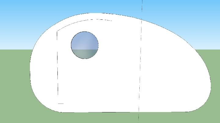

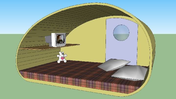

Postby tinksdad » Mon May 25, 2009 7:26 pm
I love a challenge, so the house cleaning I was working on, got put on a back burner. :lol: Your trailer just seemed more important at the time, and the accumulated dust will still be there when I get back to it.
Just by changing the front lower curve a tiny bit (it leaves a 6" high flat spot on the front), I think I was able to come up with a workable design. If I were going to make another light weight no frills, it's something that I could live with. I would seriously consider Andrews ultralight chassis for this. It would be a natural mating to shave pounds (Kg?).
The dotted line represents axle placement using the 60/40 method. I'm sure that could be adjusted slightly if necessary. I put in a non-opening porthole window for fits and giggles.
If you were to use a 4" foam mattress and shape it to the profile using an electric carving knife, it would give 6' 1" (+/- a fraction) at the top surface. It's really more room because the curves still are outbound at that point. I drew it 4' wide because I didn't know how wide you were going. Don't mind the teddy bear, he goes in a lot of my designs. I also added a ceiling surface just because it was easier for me to do it that way. You could leave the spars exposed inside to save weight. For ease of rolling over at night, the shelf really needs to be about 18" off the floor.
Hope this helps. Looking forward to seeing whatever you ultimately decide to build.
P.S. Let me know if you need an x-y plot.

Postby kennyrayandersen » Tue May 26, 2009 12:08 am
That looks pretty good. On the uber ultra I played with the front curve so that is was one radius from the floor to the apex of the trailer and I didn’t tuck it so far under. It’s tricky, because the look is good, it just has to be cheated so it looks like the look but is actually a little less tucked it – does that make sense? Engineer… words… can’t speak…. Ugh!
