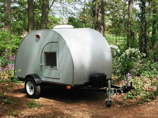

Here is my Cubby

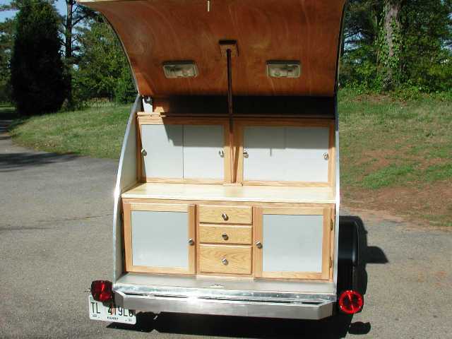

My Galley: All oak cabinets with aluminum trim

Gorgeous trailer. Nice piece o' work. I especially like that rear bumper. :thumbsup: My HF trailer had pretty much dry bearings too. One cotter pin was almost rubbing as yours. As you say, good to check it out before road testing. :yes:

Great work. The galley is very near to what I had in mind. I'll have aluminum left over and plan to use it in the galley. The sliding doors are excellent. Use them or take them out and use the space as a shelf. I'm assuming those are aluminum knobs as well. :applause:

Nice lookin' trailer. Congratulations on completing your build.
