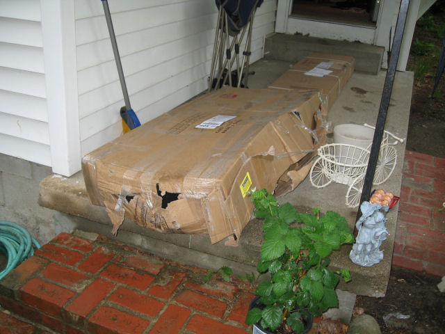

The box showed up a little beat up, but I had to dive right into it that
night.

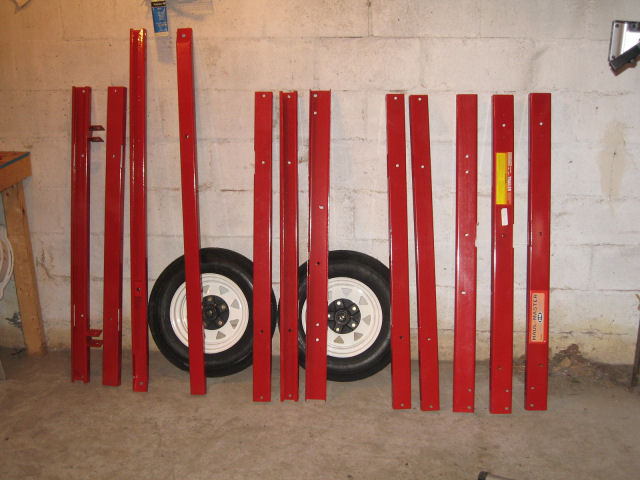

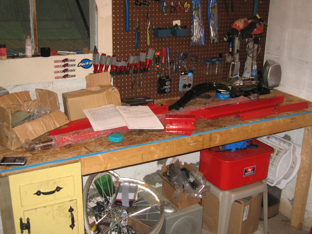

All the parts:

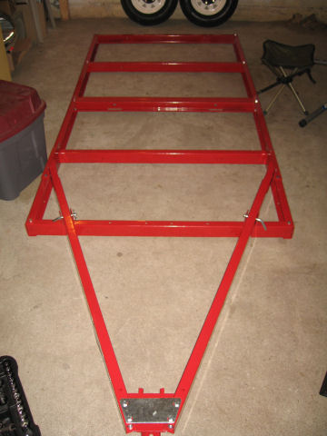

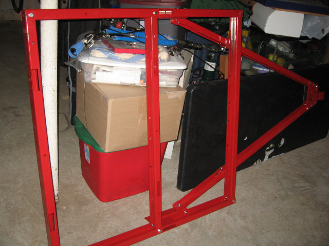

Starting to come together, the front end:
Complete frame:

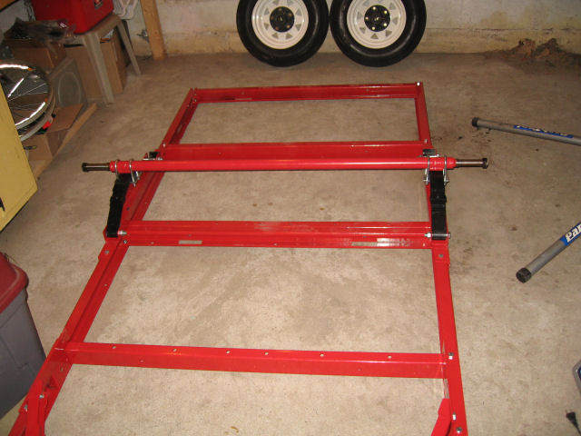

Adding the axle:
Complete trailer, ready to roll, if I can get it out of my basement:

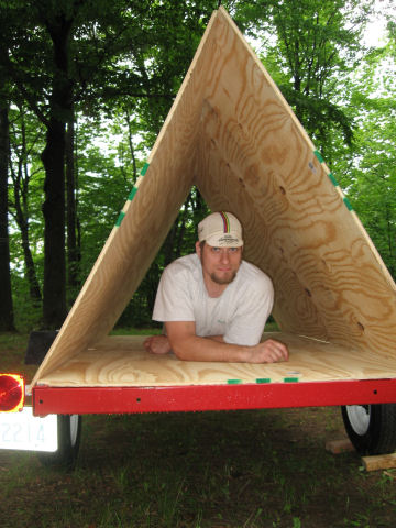

Trying out my own design...this stuff is easy:

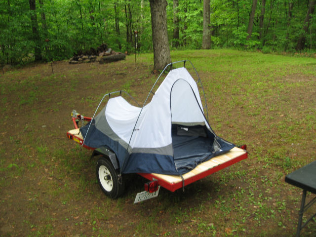

I don't think that will stand up to wind or rain much, so I tried it
with wood:
Not much room in it for 2 plus the puppy:

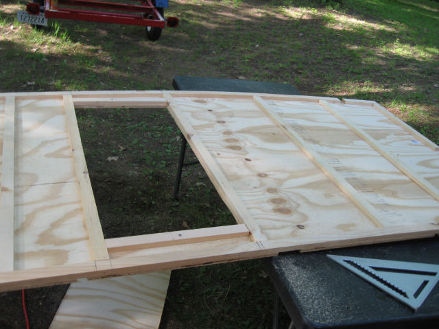

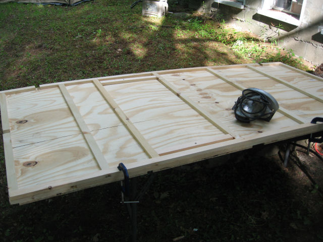

Back to the original plans, the floor. I actually used more wood
bracing it then I would have imagined, but the stronger the better.....I
guess:

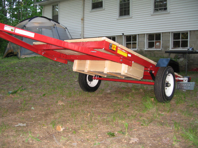

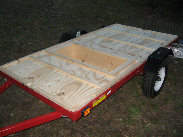

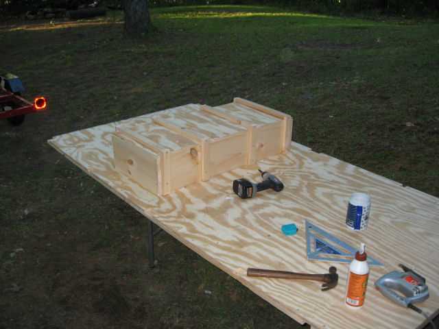

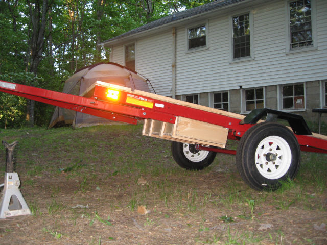

The Mrs. decided we should put the drop floor in:
On the trailer:
The box:
WOOOHOO!! It actually fits:

How far is that dropped floor from the ground?
Other than that, it appears you are off to a decent start.
Postby Mikedaub » Wed Jun 03, 2009 8:07 pm
mikeschn wrote:A bit of a comedian eh?
Gotta have fun while there doing it. Sometimes, it feels like the "Red Green Show" if any of you know what that is. I think I need me some more duct tape.
mikeschn wrote:How far is that dropped floor from the ground?
I didn't measure it to the ground. When I looked at where to put it, I just went by the axle. From the top of the floor to the top of the axle is about 12". I used 1x10's to make the box, so under theory, it is about an inch or so higher than the top of the axle. I figured if I hit the box, then I would hit the axle, and then I am in some trouble. (let's hope my theory works out :))

Postby mikeschn » Wed Jun 03, 2009 8:46 pm
Mikedaub wrote:I didn't measure it to the ground. When I looked at where to put it, I just went by the axle. From the top of the floor to the top of the axle is about 12". I used 1x10's to make the box, so under theory, it is about an inch or so higher than the top of the axle. I figured if I hit the box, then I would hit the axle, and then I am in some trouble. (let's hope my theory works out :))
It looks fine, of course... It's probably got about 10" of clearance or so...
Postby halfdome, Danny » Wed Jun 03, 2009 10:18 pm
One thing to take into consideration with a low mounted under mattress box is those driveways that rise above the street and then drop down like many strip malls have. I had a low box and the leading edge would scrape and even after protecting it with aluminum angle I finally tore it out and put in a box that's 10 3/4" above the street when the teardrop is level. My original box on TD#1 was I think 8" above the pavement and just under the doors. :D Danny
