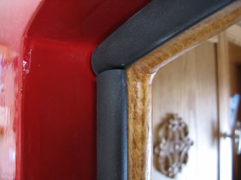

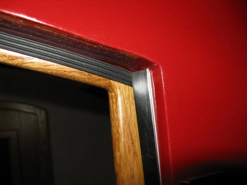

Postby planovet » Tue Jun 16, 2009 11:52 am
I agree with Snoop Dougie. I used the type you have at first but because of slight warpage, it didn't seal right at certain spots. It leaked during our first trip. I went with a D shaped seal and it works much better. It's squishier (is that a word?) and is more forgiving of variances in gaps. Of course my application is different than yours but the principle is the same. I got the seal from McMaster-Carr Link
Before:
After:
