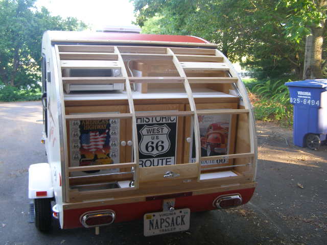

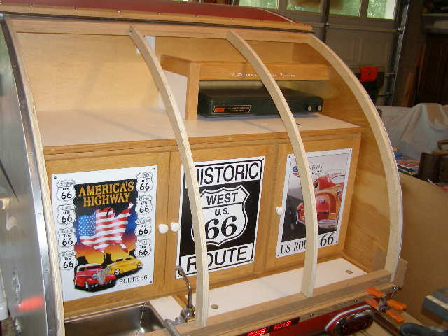

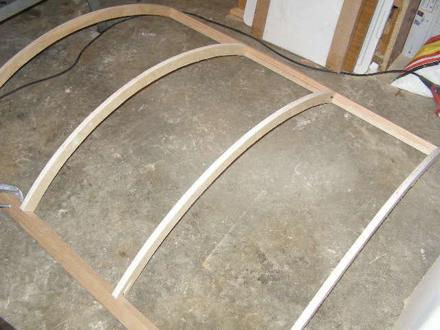

Postby Creamcracker » Wed Jun 17, 2009 12:01 pm
Got my hatch build going on today.......Philip

Postby Dean_A » Wed Jun 17, 2009 1:19 pm
Looks good! You might want to consider getting you hatch supports located before you skin it. It makes it a lot easier if you can reach/see right through while you're doing it.

Postby Creamcracker » Wed Jun 17, 2009 1:50 pm
Dean_A wrote:Looks good! You might want to consider getting you hatch supports located before you skin it. It makes it a lot easier if you can reach/see right through while you're doing it.
Yep Dean...I'm going to do that...right now I'm working on the cross - "beams"...or whatever they are called.

Postby mallymal » Sun Jun 21, 2009 9:29 am
Nice job! :applause:
What kind of height are your spars? About the same as a piece of planed 2" x 1"???
I'm designing a build and it's that constant trade off between strength and weight which I find the biggest challenge...
thanks

Postby Creamcracker » Sun Jun 21, 2009 11:04 am
mallymal wrote:Nice job! :applause:
thanks
mal
That's right Mal, that way they are flush with the cross ribs.

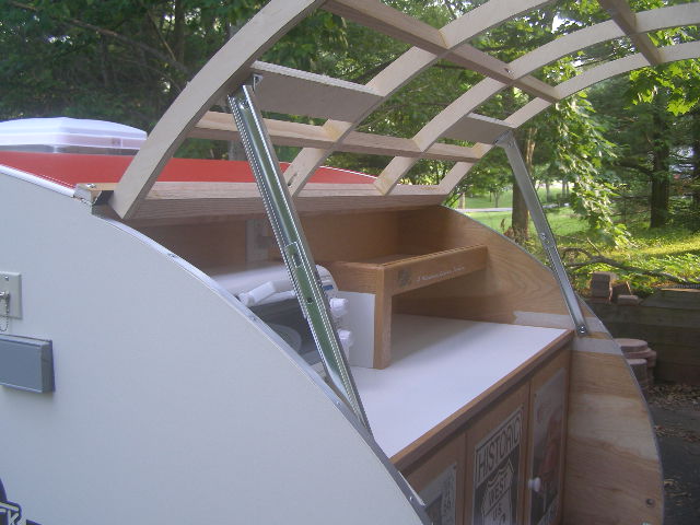

Hatch Support
Postby Creamcracker » Fri Jun 26, 2009 6:56 pm
I'm further along with my hatch build today and just got my supports on...they came today and were $9 a piece. I used the "star wheel" supports they work great and were easy to fit.

Postby kenaum » Sat Jun 27, 2009 6:47 pm
Like your hatch supports.....who was the supplier ?

Postby Creamcracker » Sat Jun 27, 2009 7:02 pm
kenaum wrote:Like your hatch supports.....who was the supplier ?
Here you are...thanks to Dean
http://www.eztruckaccessories.com/teles ... -prop.html
