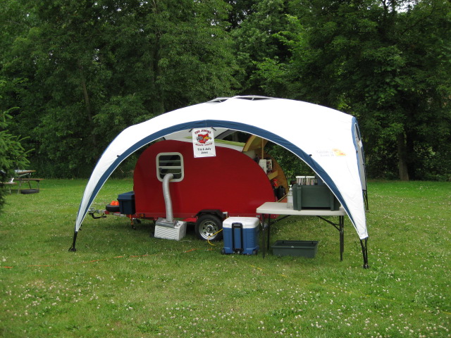

AC on ground piped in through dryer vent. Works great, and not too much $$$$$$Image
Tim and Judy
