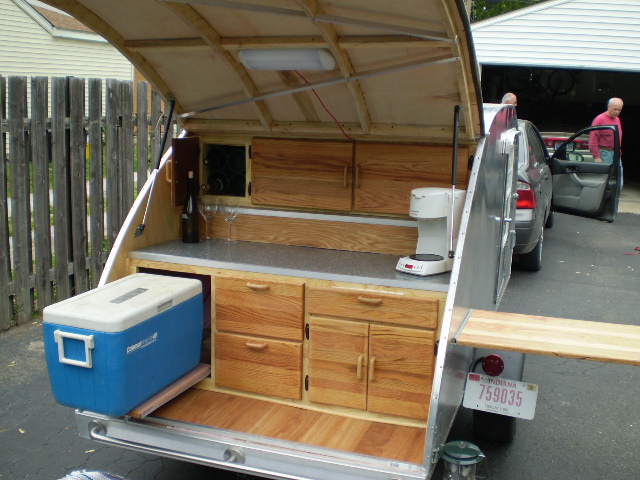

Postby dan galvin » Sat Jun 27, 2009 12:44 pm
That makes me feel good someone likes my grabbar bumper
I was surprised to see my tear without me posting it :thumbsup:

Postby Nobody » Sat Jun 27, 2009 1:27 pm
Welded a couple of lengths of 7/8" square tubing side by side, added a couple of 'L' tabs then 'wrapped' it with a tailgate protector intended for a mid-90's Chevy P/U. Bolted the tabs to 'struts' fastened to the rear frame member. Only thing about using the tailgate protector is the finish on it is some kinda 'plasticized' coating & annealing the ends to fold over doesn't do the finish any good :roll: . Don't ask how I know this :oops: . A little black trim paint does make a difference tho ;) .
Before the trim paint
After trim added
