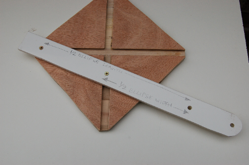

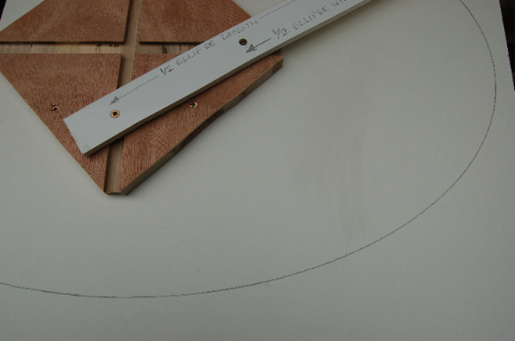

OK, so here we have a little experiment making a wooden jig which you can use to draw ellipses... in my opinion a bit more sturdy and predictable than the pencil & string method. Of course this is only the baby version, for drawing an ellipse about 24" wide, but I'm sure the same idea could be scaled up. And of course with a bit of adaptation, it could even be adapted to fit to a router...
Step 1: Get a piece of 3/4 ply or similar and mark a big x on it, making sure the lines are at absolute right angles.

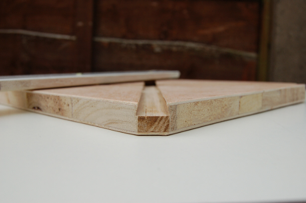

Step 2: Using a dovetail cutter in your router, cut along the x
Step 3: Make 2 dovetail shaped "sliders" - little blocks of wood (or even better nylon) which will freely slide, but not waggle, in your slotted base.
Step 4: Make a bar out of 1/4 ply or similar (I used plastic fascia), and drill according to size of ellipse... see pics for detail
Step 5: Screw through the bar where predrilled into the blocks... make them firm, but so the bar can pivot.

I built one very similar to that for my build. The arm was longer and I drilled a hole to hold a pencil to draw the quarter ellipse for the rear of the trailer. When I got the curve I wanted, I attached a plate and mounted a router to cut the panel. Worked great and I didn't have to cut with a jigsaw and then spend time sanding and fairing the curve.
