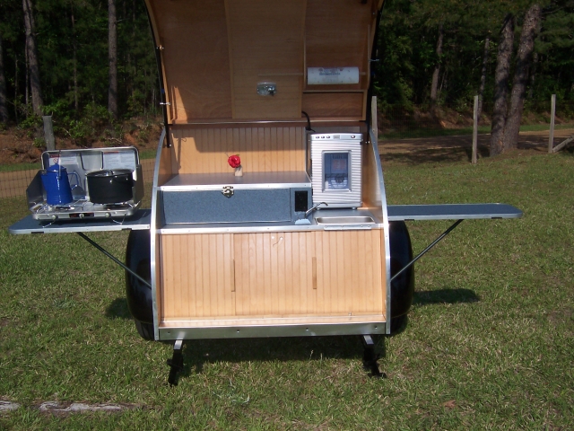

I think I know what your asking about the rear....we stopped the frame 1" short of the end of the wall...the floor, a single sheet of 1/2"ply was stopped at that point as well...I then ripped a piece of 2x4 to fit/fill the space left at the end of the frame...this piece was encapsulated in epoxy and screwed to the frame with 1/4x2 self tapping, trailer deck screws...we then bent a piece of AL sheet to form a cover for the rear and make a place for the hatch to seal against.......

I left the frame exposed in the back of the TD so I could attach my bumper. It was at a place I coulda covered it with oak trim though. Under the bumper is a hidden hitch receiver for the bike rack.

THANKS GUYS!!!, For the good ideas. The pics help tremendously. The experience on this forum is priceless....
