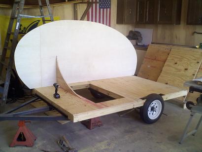

The wire grate will actually work to your advantage - you can virtually eliminate any sub floor and go with a thinner ply for the bottom. I built a small camper on a 5X7 TSC with a grated wire floor. I covered over the grating with some aluminum sheeting, then laid down the flooring. I did it this way because i planned to take the camper on and off the trailer and did not want the grating to marr the underside side of the floor

I purchased the TSC 4x8 trailer for this build, no floor or gate or side rails, but still with Cert of Origin, for around $350, and just built 6" out on either side for a 5x8. Seemed alot easier and better than building over the wire mesh. MHO
