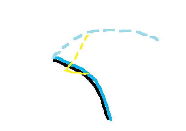

I did exactly what you talked about in your post. I took a piece of scrap and placed it under the hatch approximately where I wanted to mount the spring. It ends up being about 20" out from the hinge. The other end on a bathroom scale read about 40lbs.
I don't think that a hatch could ever exert more linear force that it actually weighs. I will agree that a 85 lb hatch could probably exert 300 ft-lbs of torque (twisting force) acting directly on a pivot point.
I think I know my problem. I've been calculating linear force as if the spring were stationary and simply lifting the weight upward. In fact, the spring will be mounted so as to face down/out first. It will press outward on the harch attachment point and require significantly more force to raise the hatch by applying force in this direction. Duh!
Please forgive the crudeness of the drawing, it's the best I can manage on my laptop with Paint.
This would explain why folks like Rob and Planovet got good results with the larger capacity springs. Thanks for talking me through it everyone! I think I'll give the 125lb springs a try and see how that works.
It depends on the mount point of the spring. If it is off center and closer to the hinge as it is in your drawing, then it will. Try the same bathroom scale setup, and with the hatch sticking straight out hang a weight on the bottom of the hatch. If the weight is say 8 pounds (gallon jug of water) then the scale reading should increase possibly three times that if the mount point is one third of the way from the hinge.
In the end, I would over-rate them for reasons others have mentioned. A wind could blow it down. And if it is too much, you can always add a weight to the bottom to compensate. Another option is to use the springs just for ease of lifting and add a stick of some kind to latch it open so no wind could possibly blow it closed.

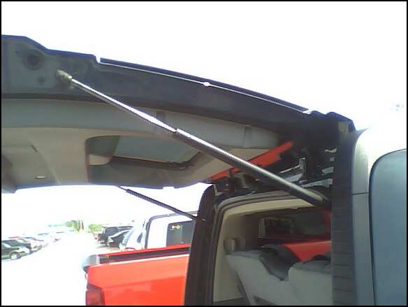

As an aside, SUV hatches mount in both orientations, depending on the model. Here's a Jeep Commander hatch set up similar to how I'm going to mount mine (close to the hinge on the body, and further out on the hatch. Interestingly...I have seen ZERO automotive springs mounted with the plunger up. I buy cars for a living and literally look at thousands of vehicles a month. I'm guessing this is done for a reason (lubrication of the seal?). So, mine will be going in plunger down as in this photo.
Thanks for everyone's help, I'll post pics over on my build thread once I have them up and in.

bbarry wrote:I have seen ZERO automotive springs mounted with the plunger up. I buy cars for a living and literally look at thousands of vehicles a month. I'm guessing this is done for a reason (lubrication of the seal?).
Yep, that's the reason. Here is an exerpt from the McMaster Carr website:
Note: All gas springs contain pressurized nitrogen gas as well as hydraulic fluid that lubricates the seal and provides slam-resistant damping at the end of the stroke. To avoid loss of force, you should store and install gas springs rod-end down.
And I mounted mine like you plan to. It works great.
