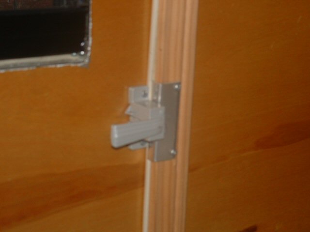

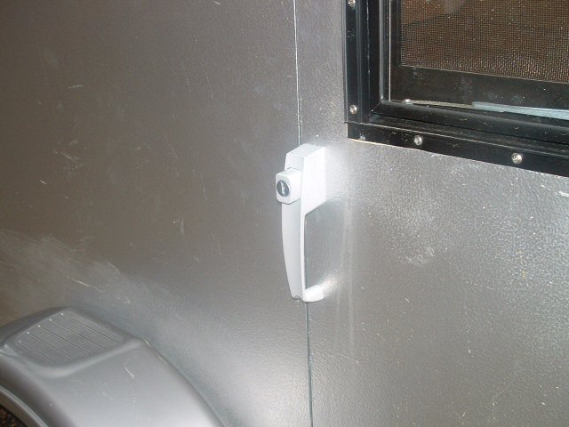

switterstx wrote:I was also thinking of using screen/storm door hardware for the latches in the doors. Has anyone else done this?
I used one on Itty-Bitty. The $18 special from the blue box store. It's key locked push button from the outside, inside thumb latch, it's mostly plastic. I did fabricate my own solid metal latch plate rather than use the spring bar that came with it. If I were to do it again, I would definitely consider a better quality model. Don't have any pics, I'll try to get some tomorrow when I get home from work.

Postby tinksdad » Tue Jul 14, 2009 3:36 pm
Here are the pics I promised.
And a "for what it's worth"..... I considered using the big box store windows (somebody at one time or another, here or in another forum, gave instructions on how to convert one big window to two smaller teardrop sized windows). I wasn't thrilled with the idea of using single pane glass, mainly for the breakability and safety factor. By the time I got done pricing out the cost of the window and the replacement plexi or lexan, it just wasn't worth the effort for the work involved. I bought crank outs from Grant. That's only my opinion though.

Tinksdad, your install looks really good. I never thought of using those for door hardware, I bet they work well.
