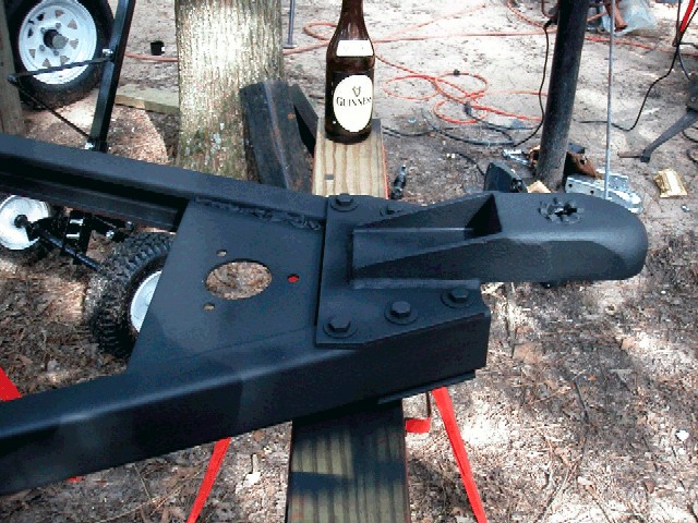

I had originally purchased a 50 degree A-frame coupler to replace the Harbor Freight coupler on my trailer. Turns out that my trailer tongue is not 50 degrees and the coupler would have been more trouble than it was worth to make it work. I really did not want to mount the tongue jack to one side of the A-frame so I used a piece of scrap metal to fill in between the channels that make up the tongue and mounted my jack there. It has worked out fine, though the jack in the picture has been replaced by a different type for ground clearance reasons. There was once a big move to get rid of these funky HF couplers but mine seems to actually work okay, it is very similar to what one of the horse trailers I grew up with had. I do not know if this is any help or not, but here are a couple of pics.
