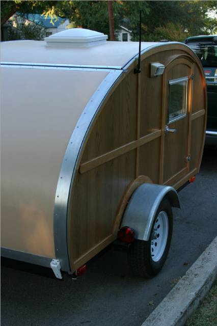

Many have used vinyl on their roofs. Creamcracker for one...Link

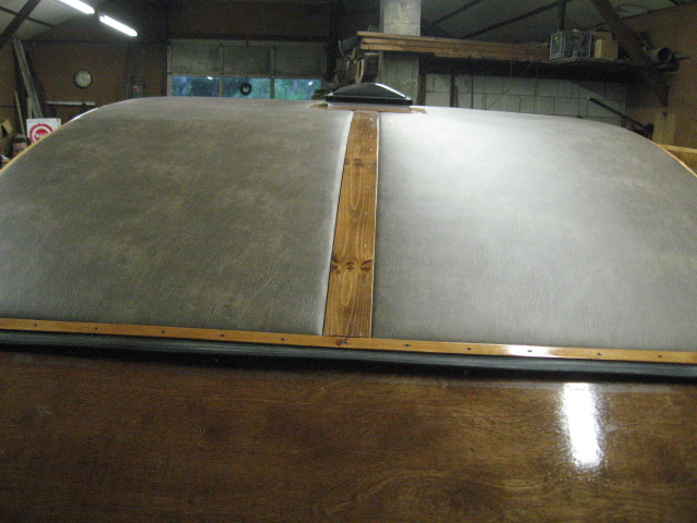

Thanks for getting back to me so soon. I'll call the local boat guys tomorrow and see what they have. I like the wooden strip down the centre. great way to cover the seam, and nice design feature.

I went to a local upholstery shop and they ordered me enough material to cover mine. It is a vinyl top material. I needed 5 ft. wide and seemed to be hard to find in the material I was lookng for. I glued and stapled down a 3/8 foam directly to the CPES top. Then worked my way around the edges, pulling slightly and stapling down the material, no glue under vinyl, them trimmed it out with alluminum. No problem at 70 mph across Nevada, and Utah. Last week.
